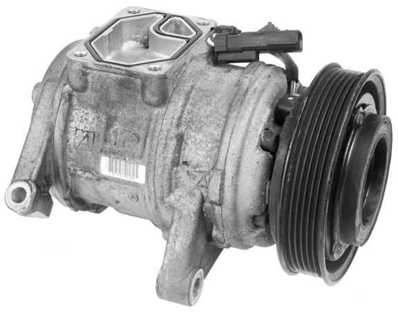

you can just replace the ac compressor clutch instead of the whole unit... that is unless the compressor housing is shot as well, and expelled refrigerant
http://images.channeladvisor.com/Sell/SSProfiles/43000297/Images/9/1521291ACM.jpg
that black thing that goes on your serpentine belt... there's tools that you can rent to remove it from the compressor
that electrical plug goes to a solenoid & that is locks the clutches to the drive pulley, "compressing" the refrigerant
