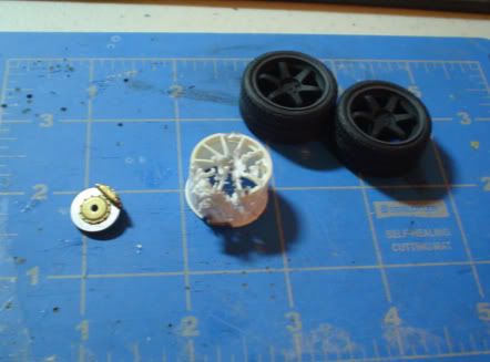

Ok.
http://img.photobucket.com/albums/v417/willimo/wheelsdisasteryoujerks.jpg
OH MY GOD LOOK WHAT YOU MADE ME DO I'M NEVER LISTENING TO THIS FORUM AGAIN I'M SERIOUS THIS TIME REALLY I'M SERIOUS I'M NOT LISTENING LALALALALA (Puts fingers in ears).

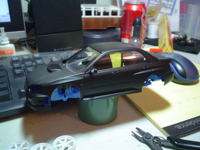

Oh, I'm working on this:
http://img.photobucket.com/albums/v417/willimo/DSC02411.jpg
Ok.
See?! It works - no paint :evillol:

Nice work. But you're supposed to put the model in the alcohol, not the alcohol in the modeler.
Ddms
