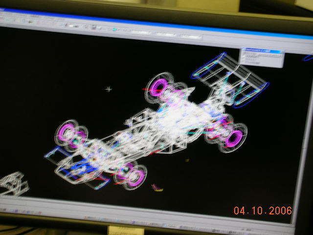

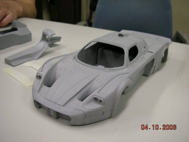

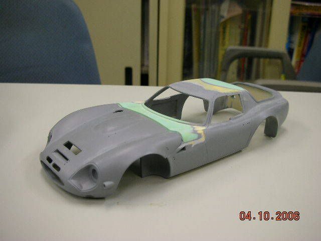

MFH kits are made by making up a master by either machining, milling, or printer. Their printer is unbelievable. It is one of those that turns goo into a solid object one layer at a time. You can sometimes see the lines. As far as casting, it is the same tried and true technique as Studio27 and several other Japanese manufacturers. It is a silcone/pressure setup. I believe they take more time making molds and have them far more supportive. The resin is also different than what is here in the US as they probably have something made there. It is similar to Smooth On which is used by HRM. If you take your time, you can have castings just as good. There aren't many american makers, but you can see some very good examples by casting companies like Quik Skins, Fisher's, Modelhaus, HRM, Replica and Miniatures, etc. They all make such good models that even the average modeler can enjoy lots of resin.

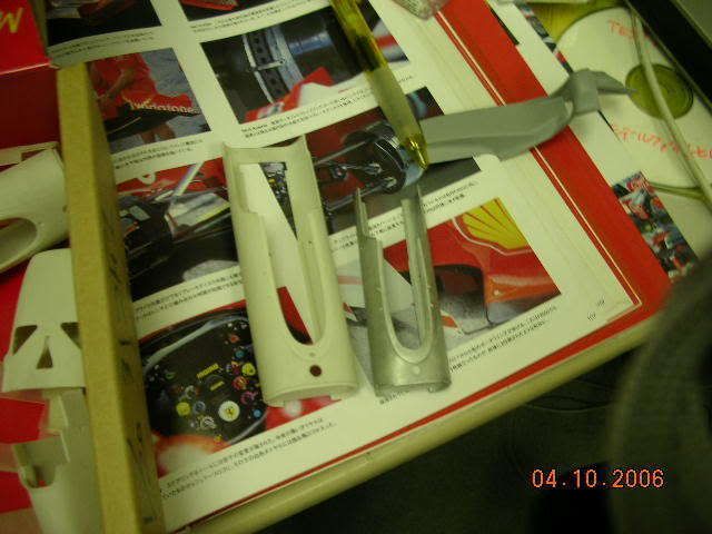

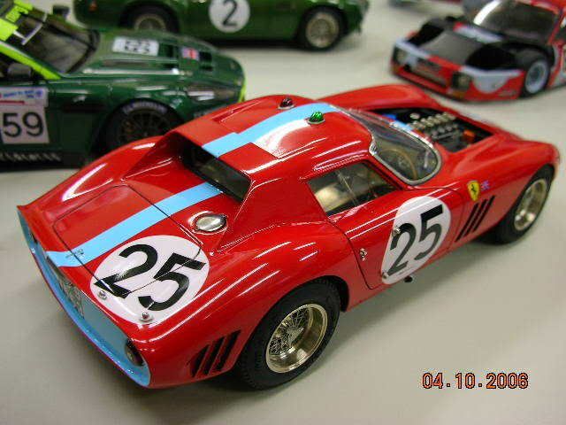

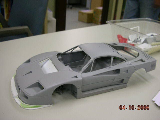

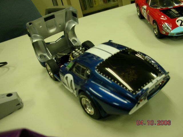

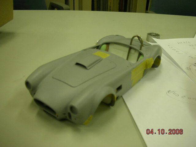

These images were posted by somebody when they visited Model Factory Hiro in 2006, and I just saved them - so I apologize for re-posting them without acknowledgment, but I just don't remember who took them!
This is MFH inside report :

Helico
04-26-2009, 10:56 PM
Wow, thanks for these interesting photos.

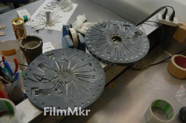

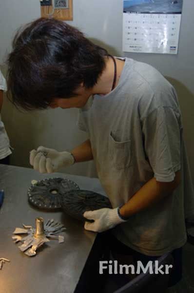

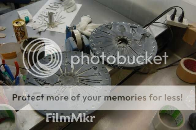

Is there a reason for making circular mold? Are they spinning while casting? So the centrifugal force will push the air bubbles out?
http://i707.photobucket.com/albums/ww75/happystevy/mfh033.jpg
He probably does all the polishing :iceslolan
http://i707.photobucket.com/albums/ww75/happystevy/mfh028.jpg

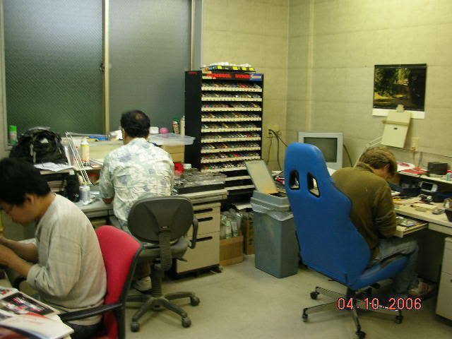

it is simply astounding that the famous Model Factory Hiro consists of only four guys and a dog.
jano11
04-27-2009, 08:31 AM
As far as I know there are a couple more men and 4 women too.
It looks like that to me:
http://1.2.3.10/bmi/i5.photobucket.com/albums/y154/jter/MFH%20Visit/mfh037.jpg
http://1.2.3.11/bmi/i5.photobucket.com/albums/y154/jter/MFH%20Visit/mfh038.jpg
However it is only for small white metal parts.
I suppose it's the same for small resin parts. However I suppose it is different for the bigger resin parts like body shells and chassis.
PS: The guy is working with hot (300-400 Celsius) metal in a T-shirt and Shorts. :eek:

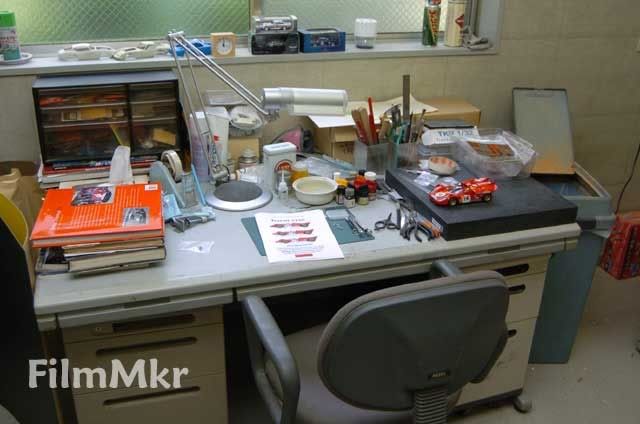

klutz_100
04-27-2009, 10:22 AM

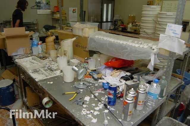

Interesting to see that their benches are as messy as mine.... :D
Yes - exactly that. Centrifugal white metal casting.

360spider
04-27-2009, 03:43 PM
These are all who showed up to work that day :-)
