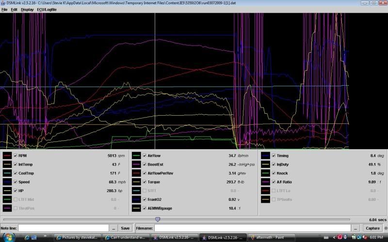

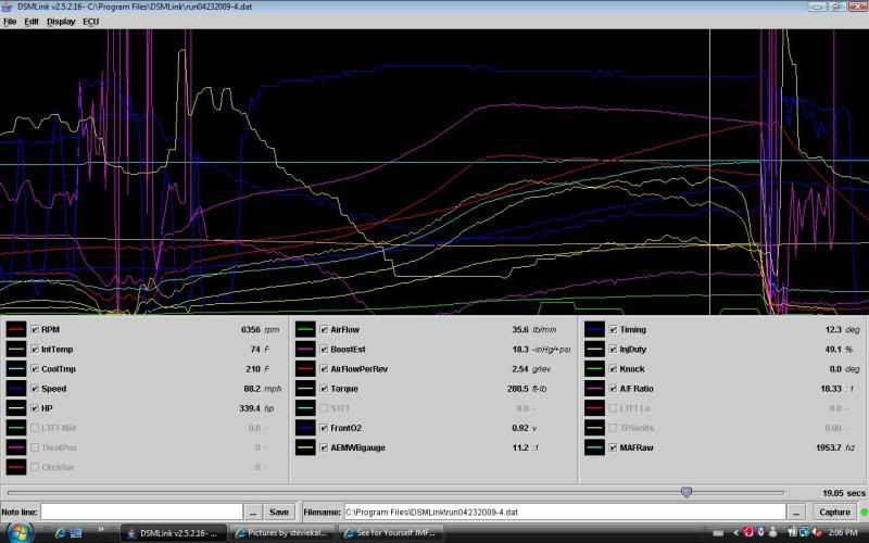

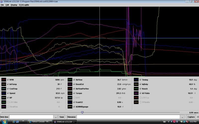

I finished my head gasket job. Finished the INtake manifold Install. Began retuning the car and the top end is just SO much freer flowing its magnificent. Not only that I got this heat barrier intake gasket and between the gasket preventing heat from the engine and the intercooler and meth spray I can run my car balls out open the engine and put my hand on the INtake manifold and it is just warm not scorching hot. Its amazing. It reduced knock so I'm sure the intake temps are down alot too.
Here is my log before meth and intake manifold
http://i83.photobucket.com/albums/j294/steviekallday/beforemeth.jpg
Here is my log before my intake manifold but after meth
http://i83.photobucket.com/albums/j294/steviekallday/aftermeth.jpg
Here is my log that I did today!!!
http://i83.photobucket.com/albums/j294/steviekallday/methjmf-1.jpg
What do you guys see :) !!!!

339hp? Very nice. So would you recommend those heat barrier gaskets? Was thinking about picking one up.
SilvrEclipse
04-23-2009, 04:06 PM
Impressive. That car is going to run awesome at the track this year

Yea but also look at the horsepower and torque curves see how much higher they stay up and don't drop off. Not only am I making more horsepower but I'm making it for much longer!
