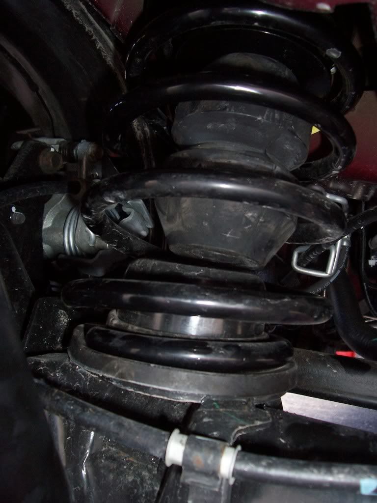

Thanks for the "heads up" about this "cable rubbing each other" problem. Tomorrow, I'll crawl under the rear of my 2009 Montana EWB van and "double check" the gap distance between its E-Cable and its rubber hose brake line. So far, both cables on my new van seem to have a 2" gap - from one another. But, will "double check" again tomorrow morning.
To view this cable area on my 2009 Montana van (that has Timbren SES "rubber blocks" installed within its rear coil springs), surf: http://i178.photobucket.com/albums/w251/Spike99-Pictures/Montana%20Van/TimbrenBottomOutsStop-2.jpg

Thanks for your picture Allbert. Think I'll crawl under the rear of my '09 Montana van and bend the E-Brake cable bracket (into a "C" shape) as well. Thus, getting its E-Brake further away from my vehicle's brake hose. Thanks for this "undocmented" improvement tip.
If you feel the rear of your van is being compressed downward "too much" (which allows both cables to constantly rub each other), may I suggest "beefing up" your van's rear suspension as well. For example:
A - Purchase / Install Timbren SES units - inside the factory coil springs. If wondering, my '09 van has these rubber blocks and they work great. And yes, I installed them myself - under 2 hours. Timbren SES units create reduction in rear suspension compression without impacting empty ride comfort. For another picture, surf: http://i178.photobucket.com/albums/w251/Spike99-Pictures/Montana%20Van/TimbrenBottomOutsStop-4.jpg
