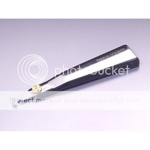

I use a Tamiya scriber for straight lines on flat surface
http://i707.photobucket.com/albums/ww75/happystevy/415YENTPk-L_SS500_.jpg

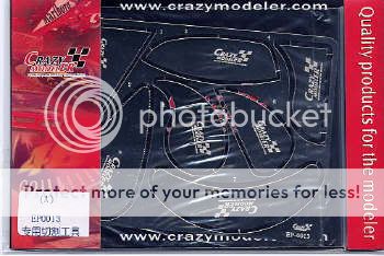

and scriber saw for tight corners, curves and around the edges
http://i707.photobucket.com/albums/ww75/happystevy/UntitledPhoto484.jpg

Crazy modeller....thats where I seen them before,I couldn't remember who and where I had seen the scriber & blades, thanks bud.

I find nothing more exotic than the back of a regular number 11 Exacto blade works best for existing straight lines. For fiddilly curves and corners try a sewing needle in a pin vice. For starting new straight lines the etched saws like in Helico's post can't be beat.
Crazy Modellers look like a copy of Hasegawa/Tritool saws.

I've used the Tamiya scriber (too wide), dental pick (not great) as well as the SRC scriber blade (a bit too thin and aggressive).

I really like my Crazy Modeler saws, by the way, but I don't think they're the best thing for re-scribing panel gaps.
