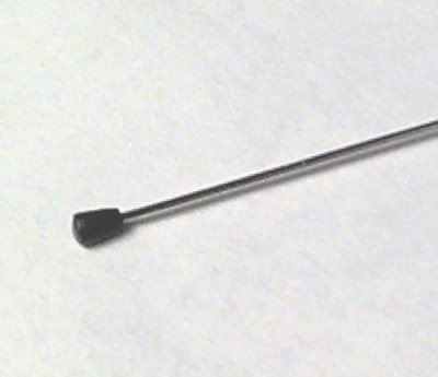

I got around to the interior and wanted to replace the stock turn signal with a better lookin’ plated pin needle.
My idea was to simply cut away the kit-supplied part, drill out the thicker end of the stalk and super glue it onto a section of a small needle that was clipped down to size.
http://i73.photobucket.com/albums/i213/Lambo63/pins02.jpg
The solution . . .

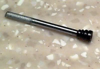

As ya know, the kit parts are very small and don’t take to drillin’ very well. So I stretched some sprue and chucked the clipped needle in my Dremel to use as a "drill bit" to get the right diameter of hole. I was then going to glue this to the needle end and work the sprue down to size much like ya would with a lathe.
As I started to insert the spinnin’ needle into the end of the sprue it was spinning at quite a high rate of speed to get the hole started (13,000 rpm). Before I had a chance to adjust to a lower speed, the plastic began to melt and adhere to the needle end (no glue required).
http://i73.photobucket.com/albums/i213/Lambo63/PICT0207.jpg
This was perfect!
I then lowered the speed to around 6500 applied a little pressure as a thin coating of the plastic continued to melt and build up on the end to the approximate size I needed. I also switched from the end of the sprue to working from the side
Once I was happy with the size, I then worked the plastic with an X-acto blade (again just as you would with a lathe and at a lower speed) to get a precise size and taper. Followed up by a light sanding with a sanding stick and then polishing with plastic polish.
Tip - Keep your blade flat on the needle as you work the end where it meets the plastic or you could scratch the plating.

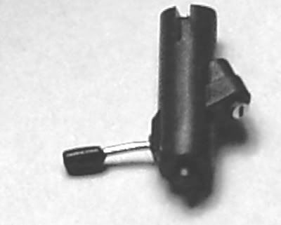

Before removing it from the dremel, I adjusted the turn signal in my Dremel to where there was a bend in the 1 to 1 turn signal and gave it a slight bend also.
All that was left to do was to drill out the steering column and install the new stalk.
http://i73.photobucket.com/albums/i213/Lambo63/PICT0203.jpg
(looks horribly out of scale here. . . but it's just the camera and lighting.)

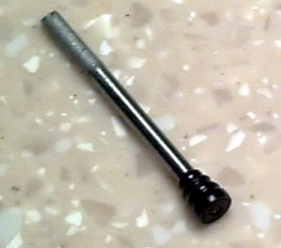

I also used this technique on the shift knob (pictured below) and plan on trying it with other small and larger parts such as CV joints using tubing.
http://i73.photobucket.com/albums/i213/Lambo63/PICT0210.jpg

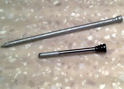

Wanted to try it out on some larger stock. . .
These are on 2-1/2 inch 8d Galv finish nails that I had layin' around which I sanded the coating off before applying the plastic. . .
Standard CV boot not modeled after any particular one. . .
http://i73.photobucket.com/albums/i213/Lambo63/cv1.jpg
http://i73.photobucket.com/albums/i213/Lambo63/cv3.jpg
http://i73.photobucket.com/albums/i213/Lambo63/cv2.jpg
I would work the end down so the nail protrudes and acts as a locater pin. . .
This also eliminates the parts being off center (even slightly) from the drilling out of kit parts. These are dead center. . .:wink:
