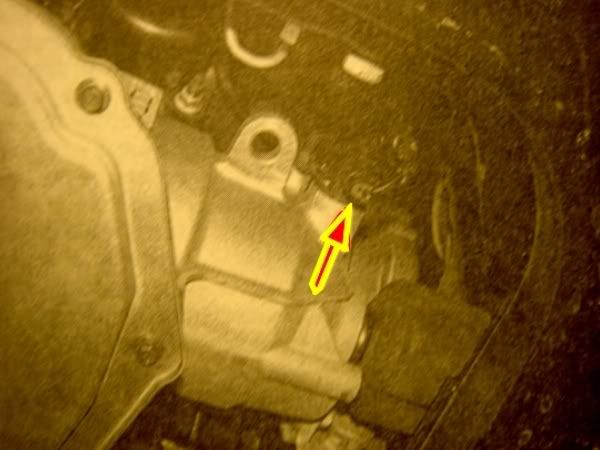

Ok thier is a Vehicle Speed Sensor - VSS on the side of the trans wasnt sure of your year GA, but here's a crapy pic of the 99-05 VSS.
http://i28.photobucket.com/albums/c242/xeroinfinity/Transmission/VSS99_05.jpg
Hope the helps and sorry for the confusion!

3100
04-20-2009, 10:27 AM
sensor is easy to replace, it is one 10mm bolt if I can remember it is going to be on the passenger side of the trans, use the picture provided by XI as a guide.
