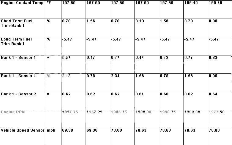

6 frames of live data I captured earlier, Nothing stands out as obvious to me, the software that comes with the 3130 is kind of lame though can't do anything with it, graphing is sort of lame too, but anyway,Anyting jump out at you ???
I appreciate your input... Thanks Again !

From what I can see the short and long term fuel trims look normal or nothing out of the ordinary. The ideal figure to achieve is 0 % but that will never happen. Ideal fuel trim = zero. Greater than zero indicates the PCM is adding fuel to compensate for the lean condition. If fuel trim is less than zero the PCM is reducing the amount of fuel to compensate for a rich condition.
The fuel trims are considered abnormal when you see the following on the scan tool.
LT fuel trim is greater than (+) (-) 17%. ST fuel trim greater than (+) (-) 2%.
BTW - The best reference to use for DTCs and the explanation of why or how they set is the GM Factory Service Manual. The problem with generic and extended code listings is not all DTCs are applicable to certain year model Grand Prixs and the respective engines. Also, they do not have the proper corrective action to take or any detailed diagnostics procedures.
Note: One of the STFT values is off but that could be the scan tool but it is not that bad. The specs are using a GM Tech 2 scan tool.
