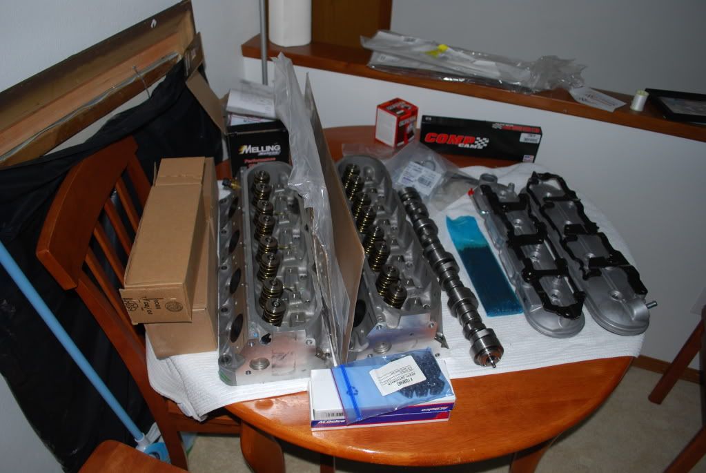

The 325hp is at the crank and the 2002 TA's put down stock to the wheels around 280 rwhp. I have a 98 z28 and all I have done is full exhaust and a ls6 intake, the ls6 intake your car already has stock they came on the 2001 and 2002 fbodys. First mod I would do if I were you is get rid of the stock restrictive air lid and get an aftermarket one like this
http://i122.photobucket.com/albums/o257/emt512/car%20toys%20car%20show/DSCN3237.jpg
Next I would do full exhaust, ARH makes a real nice stainless steel header with catted Y. Its spendy but ground clearance is very nice with this set up and you will still be emission legal. After you have the car breathing nice and you have gained 20 or so HP or more then upgrade suspension to handle the can and heads you might want to put on. I am getting ready to do a ls6 heads swap with a custom ground 224-230 cam and should make just over 400rwhp.
http://i122.photobucket.com/albums/o257/emt512/Cam%20Swap/DSC_0002.jpg
Good luck with what you decide to do. If you have any questions PM me.
