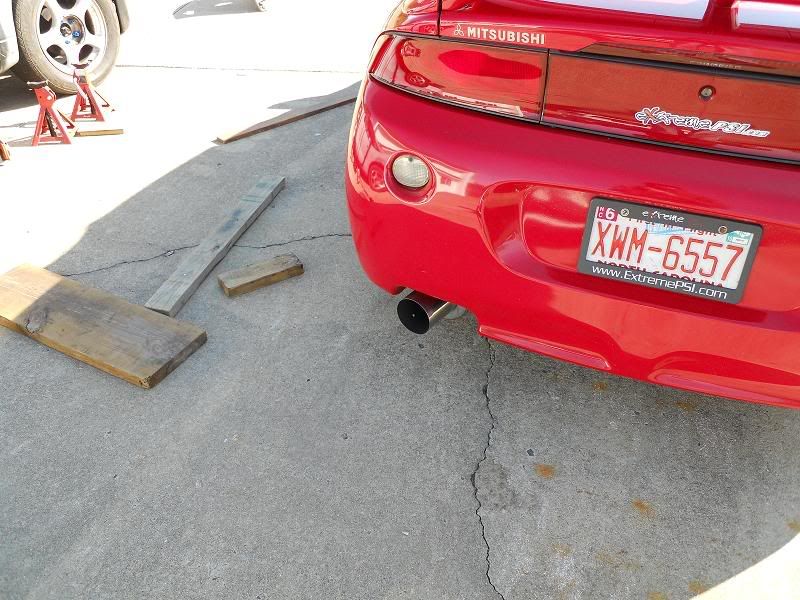

01-22-2010, 05:55 PM
Havent messed with the cars much lately.
Spyder:
I bought the same 3" ebay exhaust as Jason. It fit kind of rough, half the hangers didnt line up. Also, I had the same problem Jason was having; Where the catback bolts to the DP, the pipe was pointed down at the ground at like a 35 degree angle. So I cut the flange of the pipe and rotated it some, so that it would pick the pipe up. Also, I have an ebay 3 inch DP. The exhaust necks down to 2 1/4" where its supposed to bolt to the stock cat. I bought some extra piping and a 3 inch V-band. I am going to cut the flanges off the catback and the DP, and use the V-band to make a complete 3 inch setup. Here are some pics. I will post up more when I get done with it.
Also have some updates for my GST soon.
Extra pipe and V band:
http://i12.photobucket.com/albums/a228/nilla_pimp/exhaust.jpg
Grapefruit shooter, just held up with coat hanger for the time being.
http://i12.photobucket.com/albums/a228/nilla_pimp/exhaust2.jpg
http://i12.photobucket.com/albums/a228/nilla_pimp/exhaust3.jpg
http://i12.photobucket.com/albums/a228/nilla_pimp/exhaust4.jpg
http://i12.photobucket.com/albums/a228/nilla_pimp/exhaust8.jpg
Where the catback meets the DP. The part that will be cutoff and mated together with Vband.
http://i12.photobucket.com/albums/a228/nilla_pimp/exhaust5.jpg
http://i12.photobucket.com/albums/a228/nilla_pimp/exhaust6.jpg
Where I had to cut the pipe off the flange, rotate it and reweld. Just tacked in place for the meantime.
http://i12.photobucket.com/albums/a228/nilla_pimp/exhaust7.jpg
I will post more pics next week when I finish it up.

Finished my exhaust on the Spyder today. Came out great. Sounds very quiet, but I like it. Makes it much more enjoyable to drive. Also, Jason had mentioned that on his exhaust the muffler was pointed down some. On mine, the muffler isnt pointed down at all. I need to take some more pics 2mrw, but this is what I got so far.

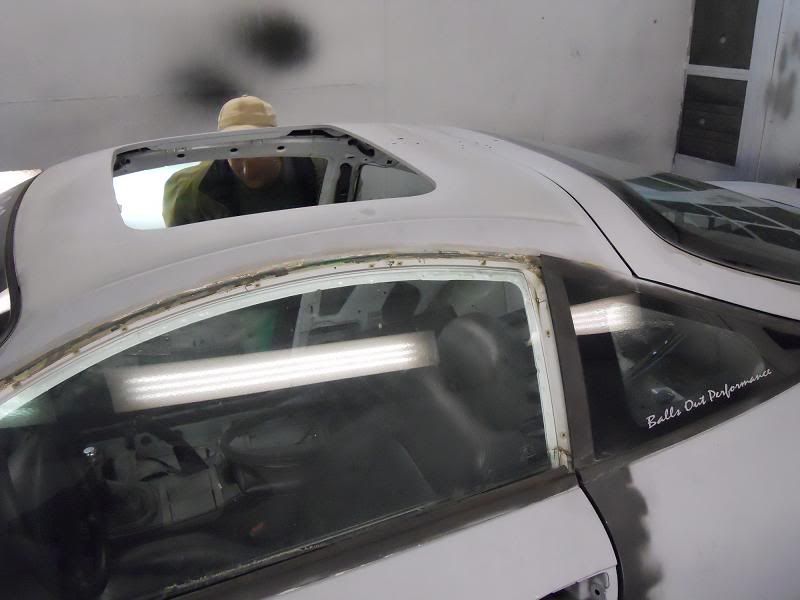

Got some pics of the hardtop. Took it to skool today and we be leaving it there while I work on it. Just done some final dissasembly today. In some pics the car was in the booth, but I wasnt getting ready to spray it or anything, I just stuck it in there.
