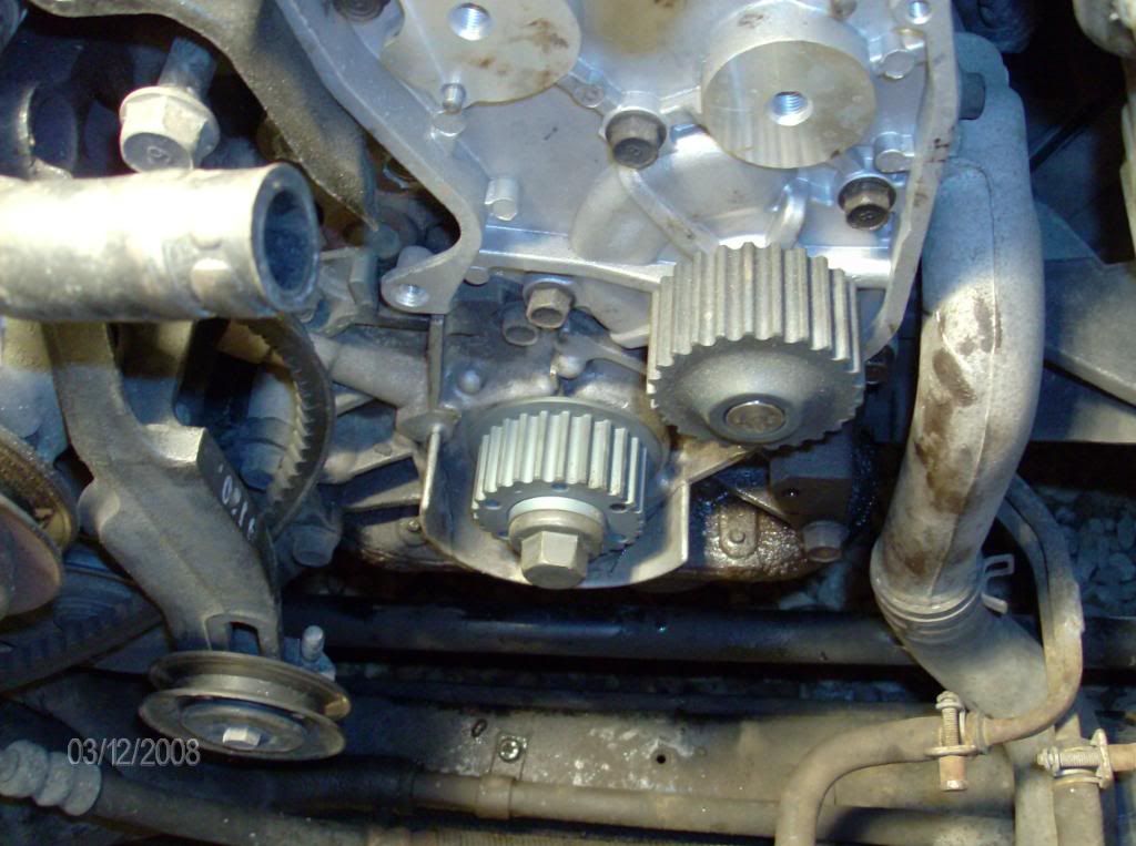

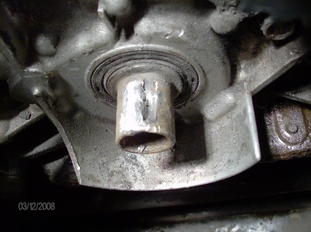

http://i257.photobucket.com/albums/hh223/jdgroh/HPIM3041.jpg
http://i257.photobucket.com/albums/hh223/jdgroh/HPIM3042.jpg
k, here is the rundown from the start.
1) i had no power and cracked manifold
a) replaced the manifold and gasket, still no power
b) replaced the o2 sensor (because i broke the old one)
2) checked timing belt, looked ok, but after closer look found keyway was bad (see earlier pics), also found that the bolt holding the crank gear was broke about 3/4 way back in. ?( which i think that the bold breaking may have started the problem ? dont know)
a) welded crank to give keyway more meat to make contact with, installed new keyway, crank gear, crank bolt, and water pump
when i welded crank, i was very careful not to get very hot and also used dremel tool to grind away excess weld, i had a snug fit, but for saftey measures i also used jb weld when puting the keyway in.
started it up and seems to run fine.
