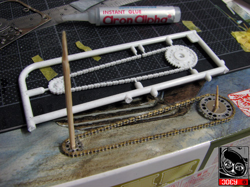

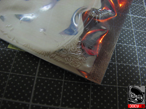

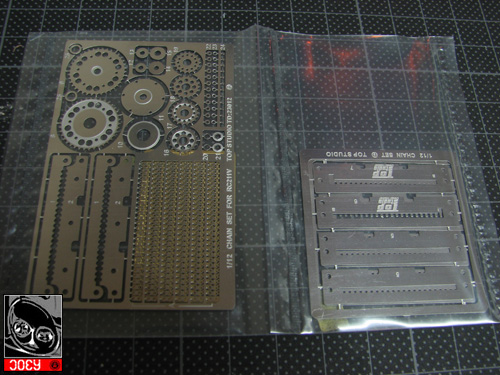

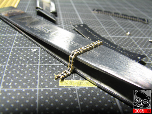

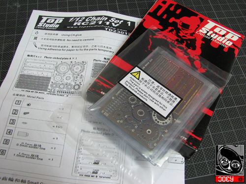

I've got some of the pics for my first TS chain. This is for RC211V.
http://www.joeyko.com/diary/rc211v_minolta/20080427_1.jpg
http://www.joeyko.com/diary/rc211v_minolta/20080427_2.jpg
http://www.joeyko.com/diary/rc211v_minolta/20080427_3.jpg
http://www.joeyko.com/diary/rc211v_minolta/20080427_4.jpg
http://www.joeyko.com/diary/rc211v_minolta/20080706_2.jpg
