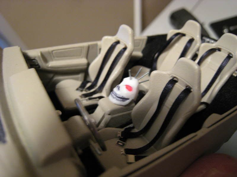

phatmitsu
07-22-2009, 05:27 PM
I use stuff from my store.. I sent you a pm with more info..
http://img.photobucket.com/albums/v401/Phatras/Built%20models/IMG_6028.jpg
Didymus
07-22-2009, 06:58 PM
They look good. What store?
Ddms
kaho
07-23-2009, 02:59 AM
Yea they look pretty nice and the size is perfect! Where did you get them from?
mrawl
07-24-2009, 05:07 AM
That looks like standard 1/8" ribbon from Michael's to me, < 1$ for an entire spool. There is a pattern down the edges which is a bit out of scale imho, though many real seat belts do have a similar pattern. Check it out, you might like it, they have lots of colors.
