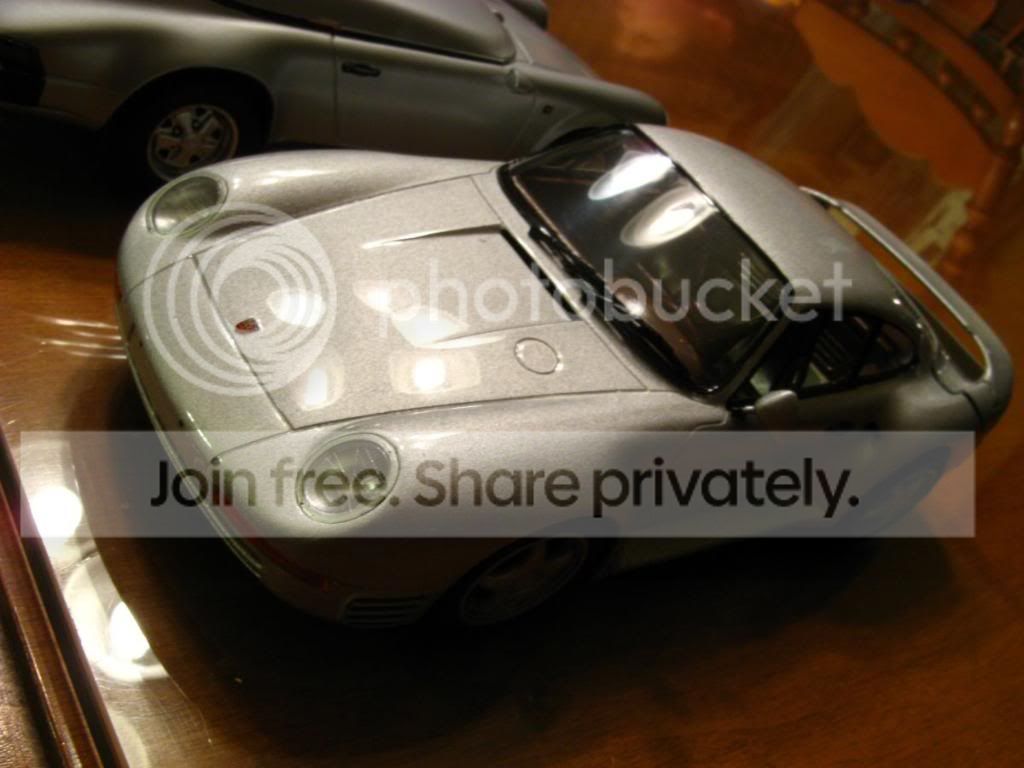

Here a ref pics of mine to show you the difference between the 2 colors... the grainy one (right) is the X-11:
http://i598.photobucket.com/albums/tt62/PhotoBee_2009/124/Speedster95903mini.jpg
By the way... the Speedster's got no clear... when I shoot it, I looked at it and loved it as it was so I finished it like that ! No rubbing, no buffing and no polishing. It's a little flat but like I said, that give her that special effect.:2cents:
To use the X-22 is very easy... I don't even thin it ! Just put it in the airbrush and have enough pressure to have a nice mist and it'll be enough. 2 or 3 coats will be enough. The trick is... "let it dry" because it not a very hard paint. So be extra carefull and weeks before manipulation. "You must resist, you must use the force Luke ! Patience !"
Easily polished, it can be top class finished (once it's cured or you'll have fingerprints on it). I find it VERY "Temperature related"... meaning that the result will vary on what day you'll shoot, temp, humidity, pressure, everything will matter. So give it a try. Maybe you are in the right area.
Ps: X's are a lot less harmful that TS in my opinion. To be verified though.:confused:
