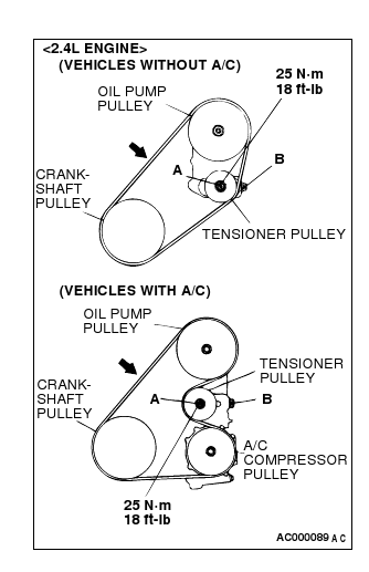

I found this in a 01' Galant service manual, should be the same for 02:
http://my.core.com/%7Eczeck1/mitgal24acps.gif
As you can see here, what is needed to by-pass the a/c is the belt and tensioner pulley from a non-a/c car. With a little luck, you may be able to tilt back the compressor brackets just enough to clear the belt, and not have to take it off.
