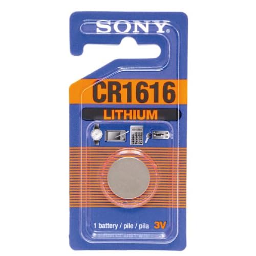

ricebike
03-02-2009, 05:17 PM
o-my so it's confirmed that the owner's manual was wrong?!?!
thanks for confirming it for future searches:licka:
can you also confirm the battery as CR1616 ? quick google search ranges the price for this battery to be $2-4
http://ecx.images-amazon.com/images/I/51495DS88FL._SS500_.jpg
