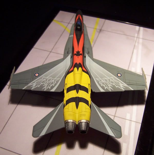

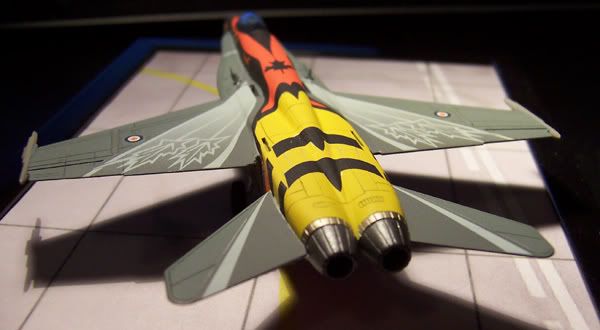

And the image below shows Alclad Pale Burnt Metal between the yellow on the fuselage and the gunmetal colour on the jetpipes. It was sprayed straight over the yellow.
http://img.photobucket.com/albums/v609/captain_mark/FA-1805.jpg
http://img.photobucket.com/albums/v609/captain_mark/FA-1806.jpg
