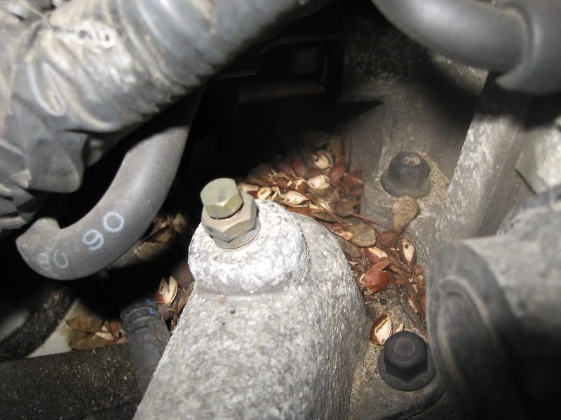

I started looking over the thermostat housing planning ahead and had these funny winged seeds inside the engine, strange, but continued on..

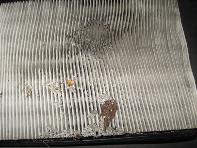

Inside the airbox and below the PCM there were two heaping handfuls of the durn things...apparently a mouse had started stashing them inside there while the car sat outside for about a month in October! The mouse had also chewed the air filter (presumably looking for more storage space :uhoh: ). Luckily I had only driven about 2000 miles since then.

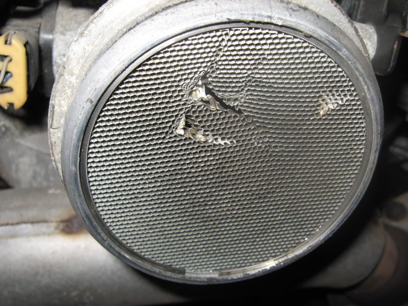

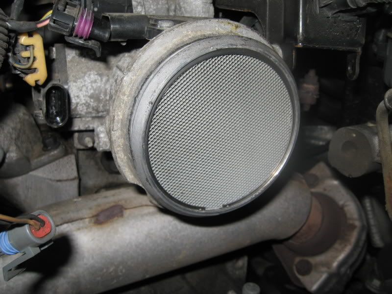

When removing the intake ductwork boot I found the flow straightener (honeycomb) had been damaged...perhaps the source of my low-rpm misfire (???). I am guessing this happened at the time when the Trans was replaced.

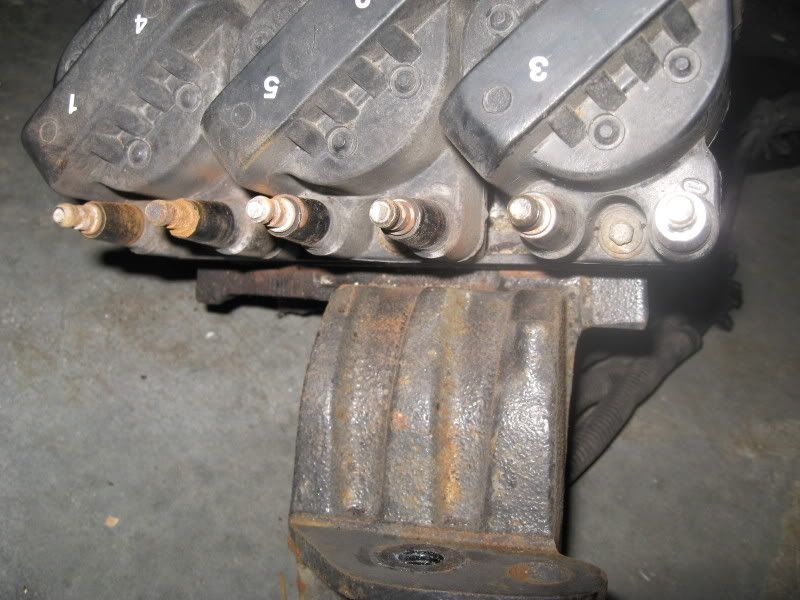

Next, changing the spark plug wires I found this...also possibly related to the low-rpm misfire condition. I cleaned these with a wire brush and gooped a lot of dielectric grease on both boots. Carefully followed the GM routing and transferred all the split black conduits and aluminum heatshields over.

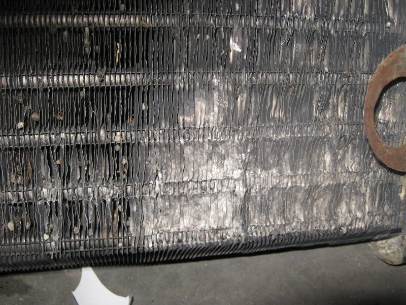

The A/C condensor had many many folded fins on the lower portion...I changed this as to improve cooling performance but also to eliminate any chance of having a weak spot and having to do the job again twice.

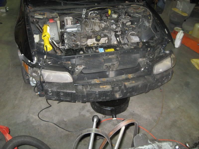

I removed the front fascias (there are two parts) as I wasn't sure what I really needed. I could have done the project without it...but I think it ended up being easier, especially with the lower/horizontal part removed.

The new flow straightener...coax the "snap ring" out of the groove with 2 pocket screwdrivers...work gently as the new part is fragile. I used a 2x2 block of wood to help seat it in the counterbore...I was worried I'd damage it with my fingers. This worked well, and the snap-ring needs a little coaxing to get back into the groove...it is not nearly as tough as a traditional spring-steel snap-ring used as a bearing retainer or other. Either the flow straightener or cleaning the coil pack posts cured the low rpm misfire completely (approx 45 mph, 4th gear locked with 2 bars of boost going uphill)

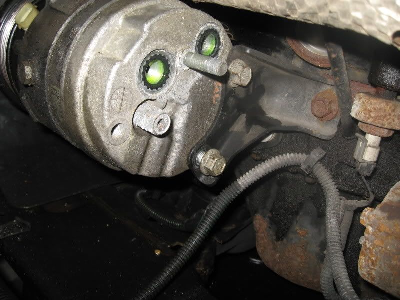

If you change the A/C compressor, removing the coil pack bracket helps greatly. There are 3x 15mm nuts on the pulley end of the compressor and 2x 15mm bolts on the back end of the compressor. I also had the advantage of the AC condensor and the radiator out of the way...but definitely not necessary. I assembled the suction and discharge hoses to the compressor to avoid any contamination before I installed this assembly into the car.

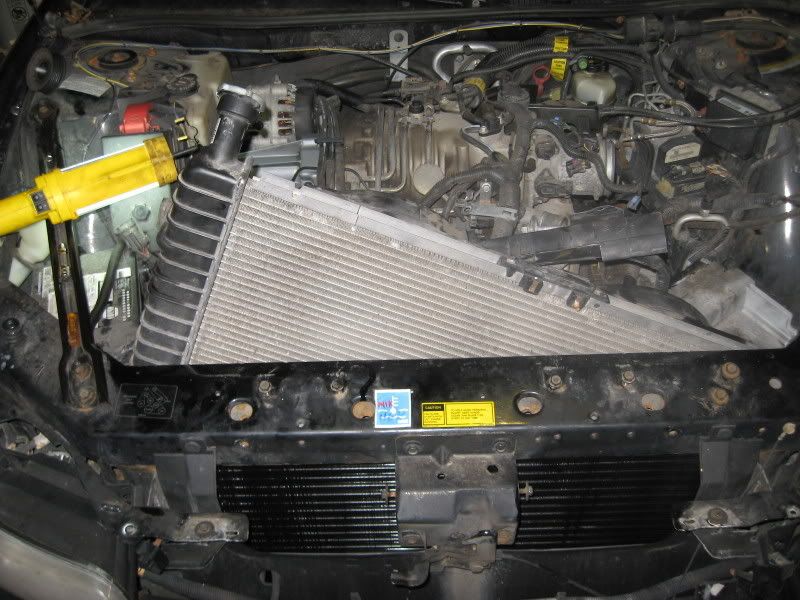

The radiator can only be removed or installed like this...the reason is the radiator "pilot" which seats in the sheetmetal support must "hook" under the connections to the AC condensor which is directly above this. The trans cooler lines I found easy to use a pocket screwdriver and very carefully pry out the spring-wire clips. Advance Auto sold me the "proper tool" which wouldn't even fit over the lines...I returned this. The spring wire clips are easily reinstalled into the connector bodies later. The lower fascia must be off to access the lower line unless you have a 3 foot long neck or the dexterity of a cirque de soleil performer :)

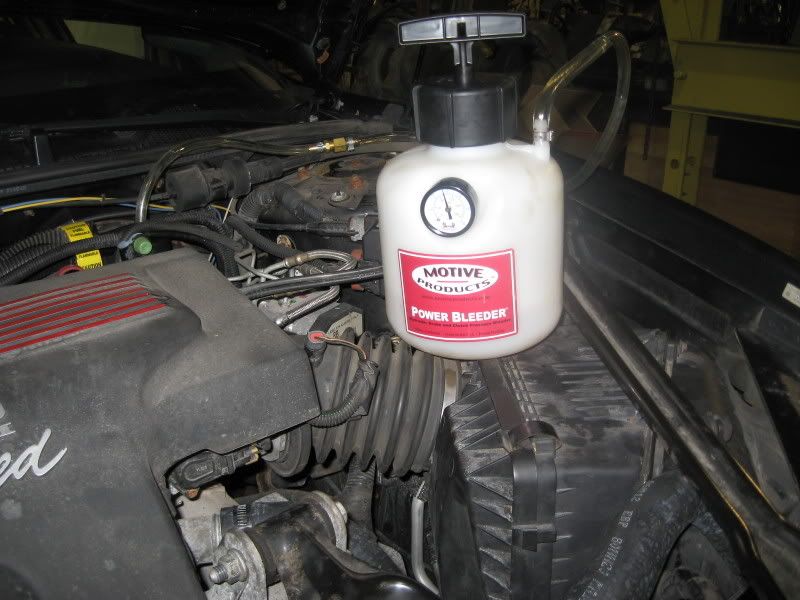

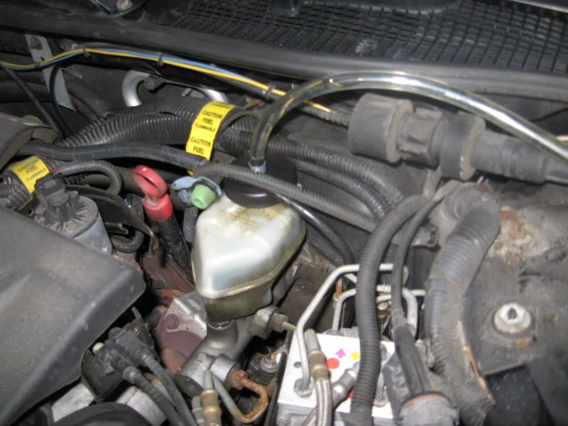

I own and use the Motive Products 1-man brake bleeder...best one I've yetused...bought this from Summit Racing.
http://i122.photobucket.com/albums/o245/matt_of_vinings/IMG_0094.jpg
I had to order a new 3-prong adapter for the GTP...the older pickup trucks use the big "bathtub" brake fluid reservoir which uses a different adapter.
http://i122.photobucket.com/albums/o245/matt_of_vinings/IMG_0095.jpg

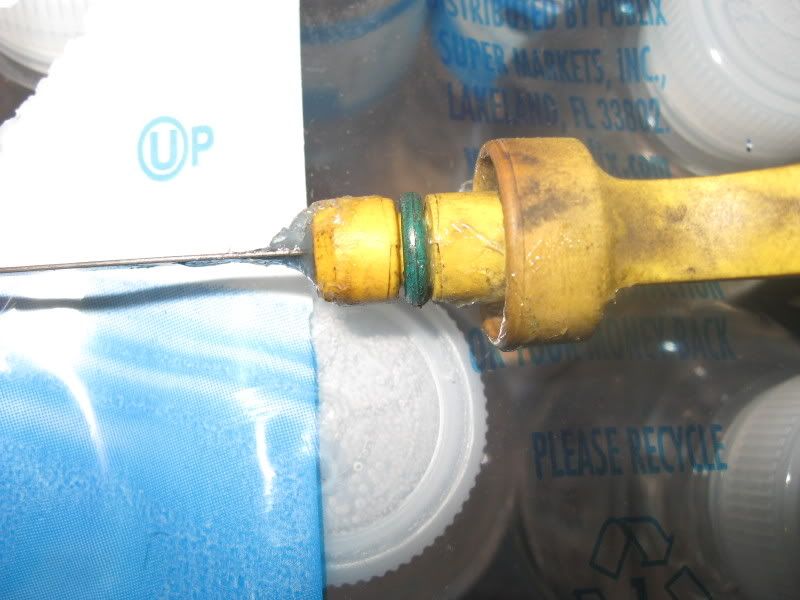

Last...as a final insult, I broke my dipstick handle...in two places. One up under the "cover" and the other right thru the o-ring gland. Being in somewhat of a hurry but not wanting to drop the parts down the stick and into the oil pan, I elected to use some globs of RTV sealant...this worked very well until I can get another part. The looped handle is the "corporate" handle which is pinned to different sticks for different carlines and many many many were broken at the assembly plants. The newer handle is tougher...
