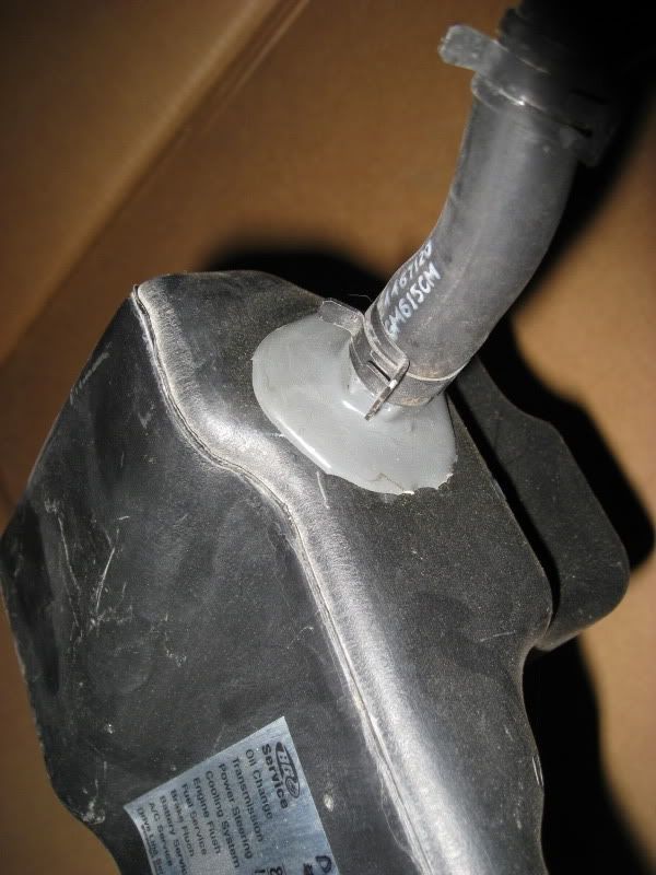

xdarkox84
12-29-2009, 05:16 PM
hi everybody,i know that its been a while on this topic,but i have exact same problem ,my resonator air box broke,and i have this yellow peanut butter thing,im wondering how did u manage to connect pcv hose to resonator box

I had that happen on mine... it's a terrible design, oil gets on the plastic and softens it. What I did was find a threaded fitting and a matching tap and tapped the hole for the fitting. I used a nylon one for low cost (as I was replacing the factory intake w/ a supercharger in a couple weeks), but I would strongly suggest brass or steel for a long-term repair. I coated the threads of the fitting with a two-part epoxy, you don't have to use as much as I did, I only used that much because we have pre-measured epoxy cups at work, which is where I was when I repaired it. It was either use it all or waste it. The reason for the epoxy was that you don't want to damage your new threads (and the plastic is very thin and kinda soft). I just snugged the fitting by hand and let the epoxy dry for a couple hours, that was the regular 24 hour dry-time (exactly like JB Weld, which is what I use at home). You could use the quick dry stuff too, don't need much holding strength, just to seal it and keep it from turning out.
http://i253.photobucket.com/albums/hh68/J-Ri/Airbox.jpg
And since I didn't see it before, here's my thoughts on the questions presented before:

Issue #2
The bandaid fix on the resonator seems to be holding up. I put an OEM hose back on to replace the straight hose I had put on last weekend. (It was slightly kinked and probably would have been fine but I wanted to put the right one on anyway.)

Issue #2
