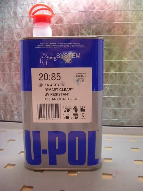

Steve, do you decant UPOL clear? If so, do you thin it or shoot it as-is?

This is the U-POL 1K that I use
http://i17.photobucket.com/albums/b61/stevenoble/Fishing002.jpg
It comes in a 1ltr can, pre thinned for spray gun use. But its a little too thick for the airbrush so I thin it with basecoat thinner the same stuff used to thin Zero paints, Ratio 1:1
