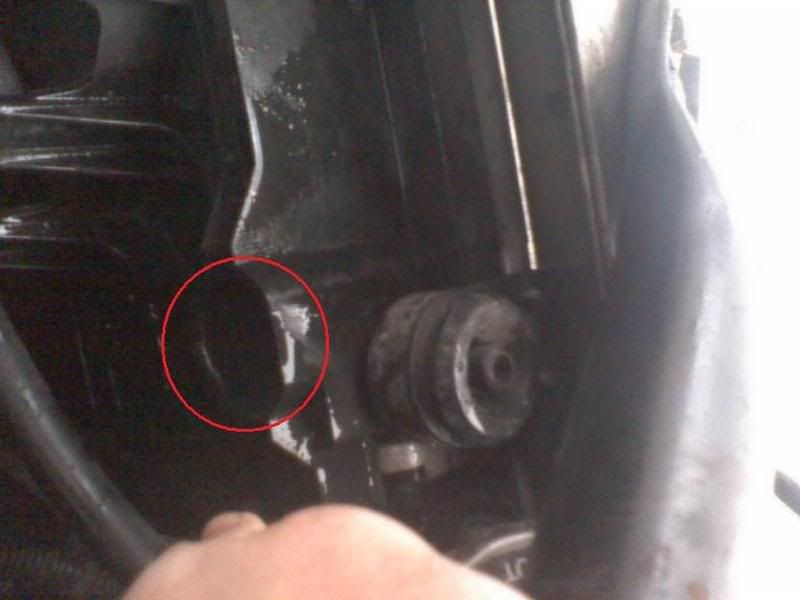

layusn1
01-28-2009, 09:38 AM
OK, I took this with my cellphone from the passenger side of the van. Sorry about the hand, had to move a hose to the side so you could see the hole.

LMP
01-28-2009, 10:14 AM
..thhis hole does not seem to be in a part of the radiator itself...rather in a metal cover over the radiator, and it is well outside the radiator tank area....http://www.avigex.ca/xport/hole.jpg we can clearly see the place where the cover is joined to the actual radiator core, to the right of the "hole" (...right, once the photo is rotated to its correct orientation).
THis hole is not a defect...but if coolant is spewing through it, then the radiator behind is damaged or the seal between the core and end tank is damaged....that just happened to my son's Caravan....
NOw...did you start the engine since you discovered that coolant spraying over the engine? IN fact, this "hole" may not be involved with that, and coolant might very sell spew from another area. I'd test the case to have a better idea of what happens, see if engine reaches steady operation temperature, if heater works normally and delivers heat; at this point, the problem needs to be documented some more....
rhandwor
01-28-2009, 10:23 AM
Either find a friend who look at the hole and check if it isn't threaded so he can screw a plug into the hole. Otherwise pay him to remove the radiator and take it to a radiator shop. Pictures won't fix the leak.
merc81
01-29-2009, 12:03 PM
Look down inside the engine compartment. You are missing the coolant level sensor. Its held in place by a flimsy clip. Unless someone stole yours, it should be dangling down from the wire harness. Just plug it back in. You may need to make a new clip out of a paper clip if yours is missing.
