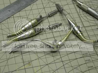

Sorry for resurrecting a old thread.
I found this tutorial on exhaust painting while I was searching for a tutorial on connecting electronic plug (other thread). Although in this particular tutorial the painting was done on 1:12 bike exhaust, the same technique can be adapted to cars (of course, with less complicated soldering pattern :icon16:).
Here are some pics. Check www.topstudiohobby.com for the complete tutorial
http://i707.photobucket.com/albums/ww75/happystevy/2.jpg
http://i707.photobucket.com/albums/ww75/happystevy/7.jpg
