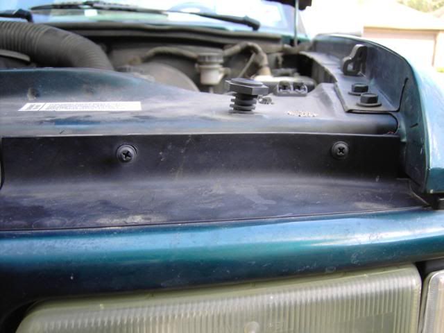

1. There are 4 screws holding the bezel in place, two at the top of the bezel and two at the bottom.

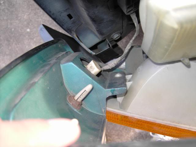

2. Once the bezel comes loose disconect the turn signal lights housed in the bezel. the two lights come out by turning them counter clockwise 1/4 turn. There might be some struggle with side marker because the seal gets stuck.

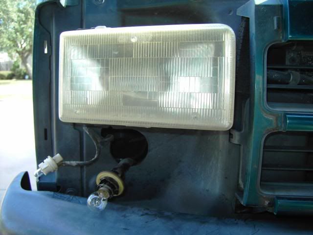

3. With the turn light and side marker out the bezel can be removed and stored for later re-assembly.

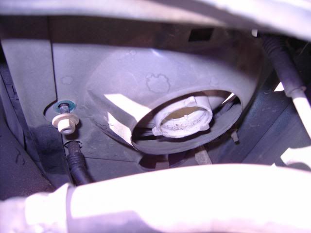

You should have now plenty of room to move your tools in place for the removal of the nuts. Use your 10mm socket for this job. This jobs come our very easy this way and with all this stuff out of the way you reduce the risk of loosing one of these nuts. The two adjustment cables that are connected to the assembly come out with by pulling on them.

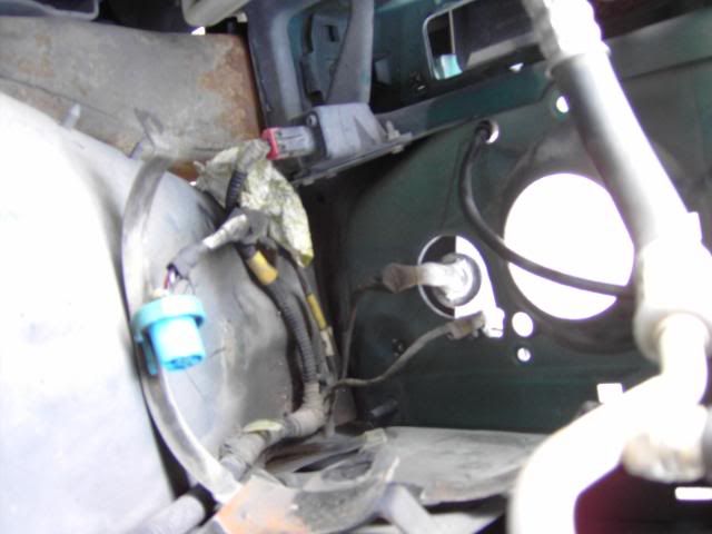

I got ahead of myself and forgot to mention that you also need to remove the lightbulb. All you need to do is 1/4 counter clockwise turn and the light bulb should come out. The hardest part is to avoid breaking the connector to the light bulb. years of wear turn the plastic brittle. Mine broke at the clip at both sides but I just bought some heat resisting tape at the autopart store and my lights work fine. By the way, my replacement headlight assemblies came with new bulbs so I wasn't too worried about keeping the bulbs clean.

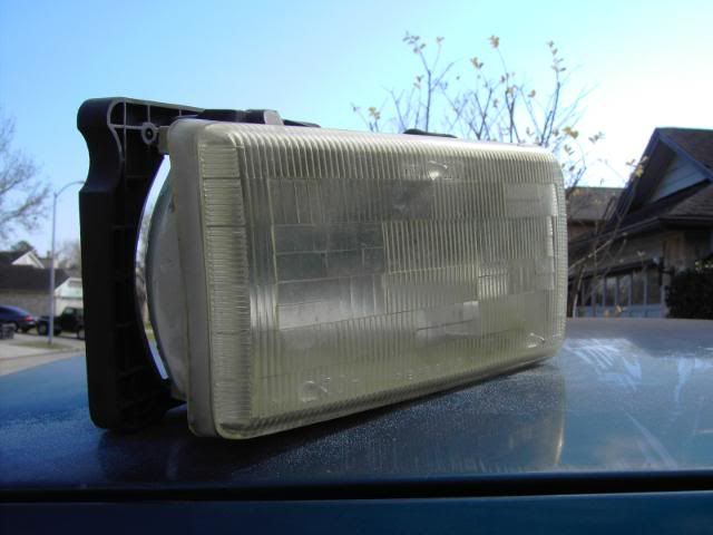

With the battery out of the way the three nuts are very easy to reach. Remove the three nuts and the headlight assembly comes out without much struggle.

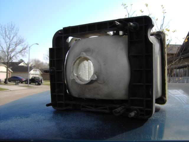

http://i185.photobucket.com/albums/x125/Tacuvito/Etcetera042.jpg
http://i185.photobucket.com/albums/x125/Tacuvito/Etcetera041.jpg
6. Installation of new headlight assembly is the reverse of removal. Upon completion of this job adjust new headlights. It took me 45 minutes from start to finish.
