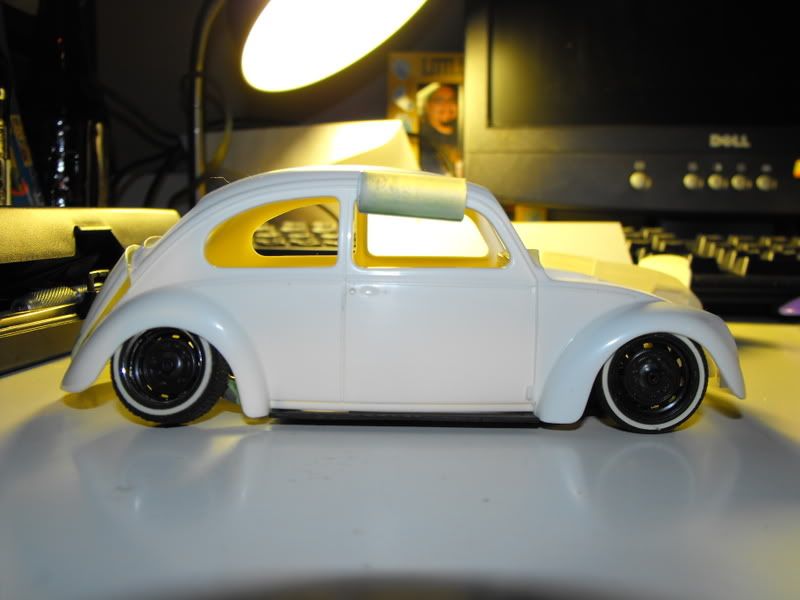

iv'e put my corona project on hold to do this.

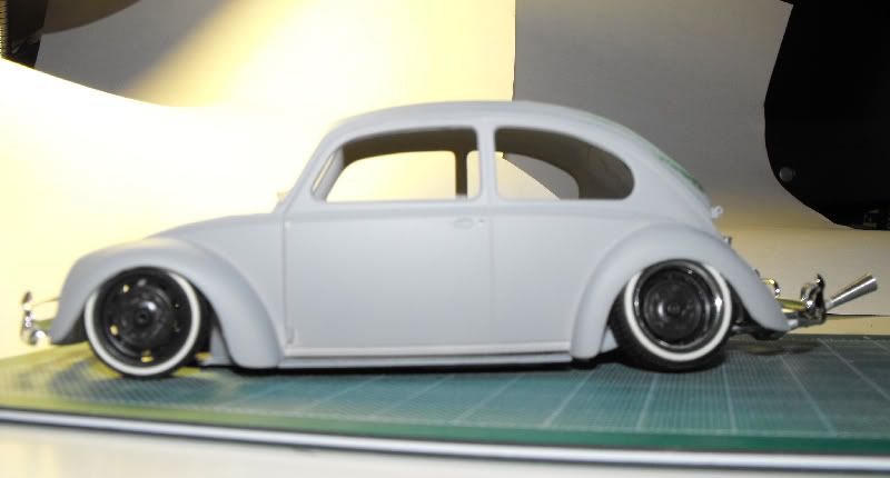

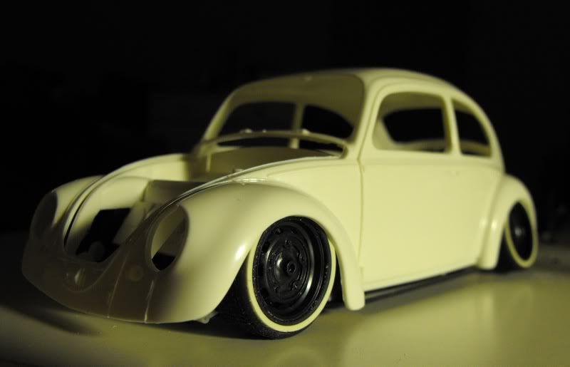

tamiya 66 beetle kit. slammed.:evillol: allot of work is going into this.
stuff i've never done before. im currently working on the header and will be finishing the carb set up. after that, interior work.
http://i136.photobucket.com/albums/q192/TRD4AG/vdub/vw1106.jpg
http://i136.photobucket.com/albums/q192/TRD4AG/vdub/vw2173.jpg
http://i136.photobucket.com/albums/q192/TRD4AG/vdub/vw2174.jpg
roof rack.
http://i136.photobucket.com/albums/q192/TRD4AG/vdub/DSCF1119.jpg
http://i136.photobucket.com/albums/q192/TRD4AG/vdub/DSCF1120.jpg

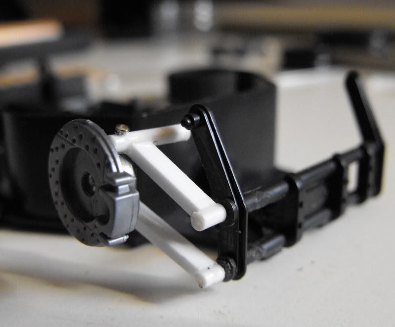

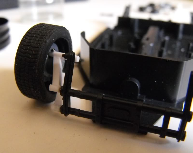

narrowed beem and disc brake conversion.
http://i136.photobucket.com/albums/q192/TRD4AG/vdub/DSCF1121.jpg
http://i136.photobucket.com/albums/q192/TRD4AG/vdub/DSCF1125.jpg
one off control arms
http://i136.photobucket.com/albums/q192/TRD4AG/vdub/DSCF1114.jpg
http://i136.photobucket.com/albums/q192/TRD4AG/vdub/DSCF1115.jpg
rear shock plates for realllllly low v-dubs.
http://i136.photobucket.com/albums/q192/TRD4AG/vdub/DSCF1116.jpg
how it sits on all fours.
http://i136.photobucket.com/albums/q192/TRD4AG/vdub/DSCF1124.jpg
some dual carb action and stinger muffler.
http://i136.photobucket.com/albums/q192/TRD4AG/vdub/DSCF1128.jpg
http://i136.photobucket.com/albums/q192/TRD4AG/vdub/DSCF1138.jpg
http://i136.photobucket.com/albums/q192/TRD4AG/vdub/DSCF1151.jpg
http://i136.photobucket.com/albums/q192/TRD4AG/vdub/DSCF1157.jpg
thanks for looking.:wave:

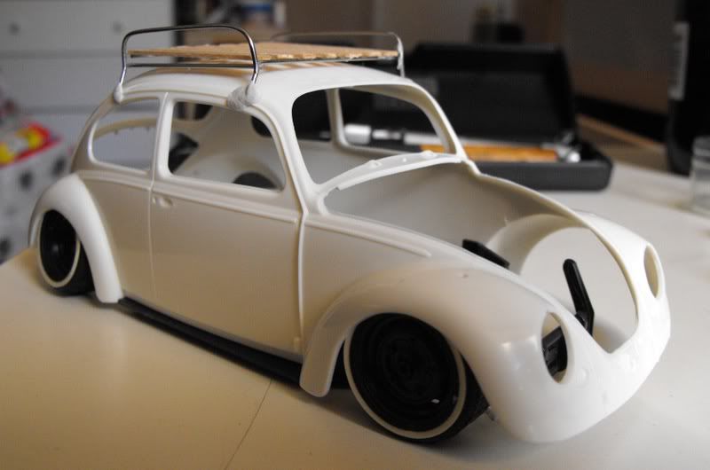

roof rack.

thanks guys.
i use reference pics to help out. i did not take pics of how i made the rack. but i just bent some stainless tig/welding rod. got some 1/8 wide 1/16 thick wood and went at it.
i need to solder the stainless for it to hold better. glue just does not do it.
the tires are from some wire/low rider wheels i had from a few years back.
i wanted to go a different route for the suspension and this is what i got.
it surprised me that i could not use the stock suspension. it pulled it to far forward. i like to keep things centered.

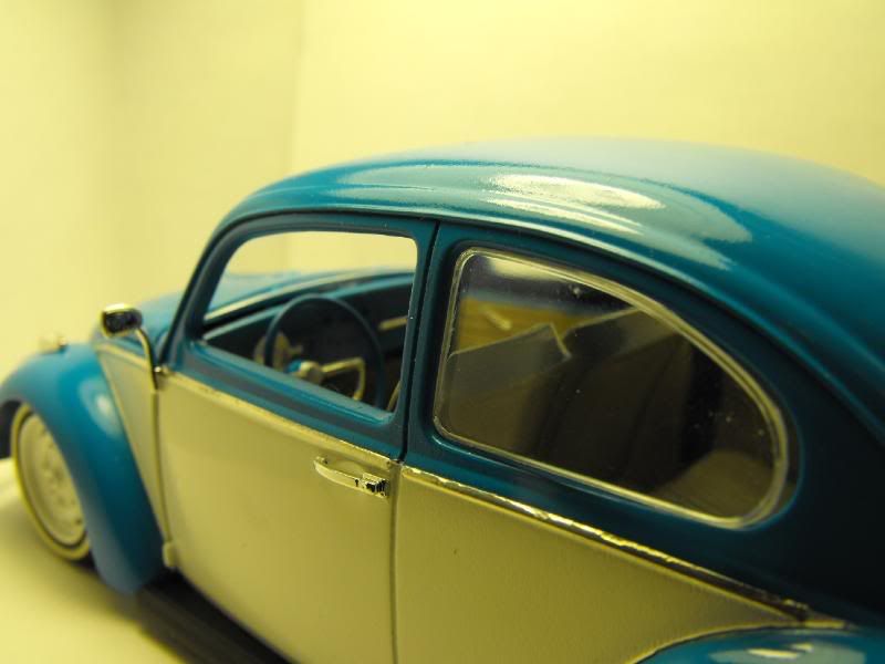

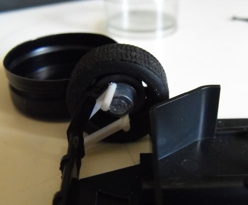

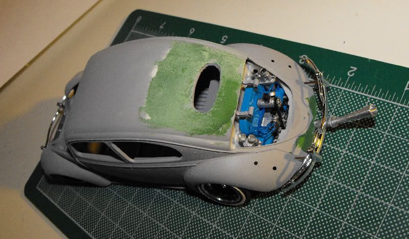

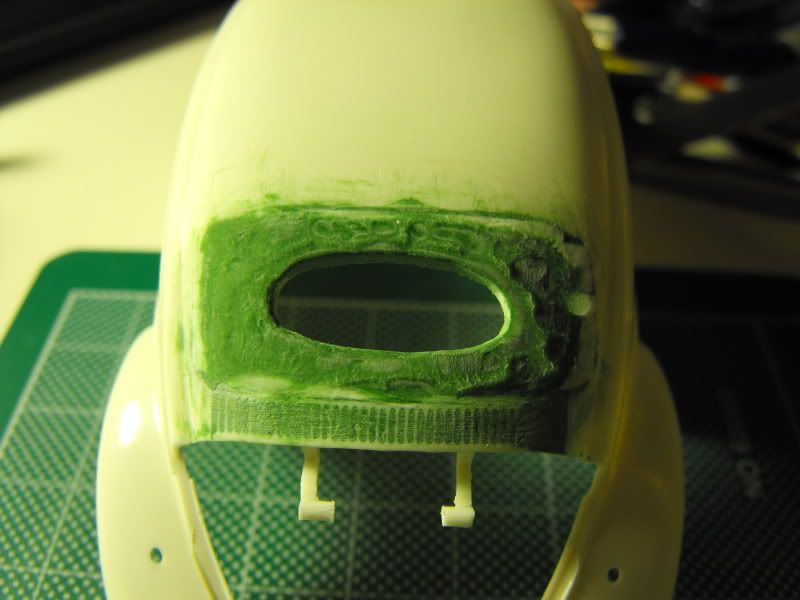

got some work done so here's a bit of an update. i like the 55's rear section, oval glass. so i decided to convert and also made hinges to "prop" the hood. air induction for dual carbs and better cooling of engine. 8)
http://i136.photobucket.com/albums/q192/TRD4AG/vdub/DSCF1185.jpg
http://i136.photobucket.com/albums/q192/TRD4AG/vdub/DSCF1174.jpg
http://i136.photobucket.com/albums/q192/TRD4AG/vdub/DSCF1184.jpg
http://i136.photobucket.com/albums/q192/TRD4AG/vdub/DSCF1186.jpg

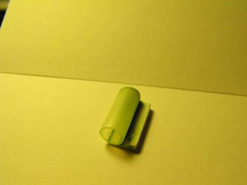

made this as well. know what it is??
http://i136.photobucket.com/albums/q192/TRD4AG/vdub/DSCF1176.jpg
if you don't then here's a clue.
http://i136.photobucket.com/albums/q192/TRD4AG/vdub/DSCF1179.jpg
http://i136.photobucket.com/albums/q192/TRD4AG/vdub/DSCF1180.jpg

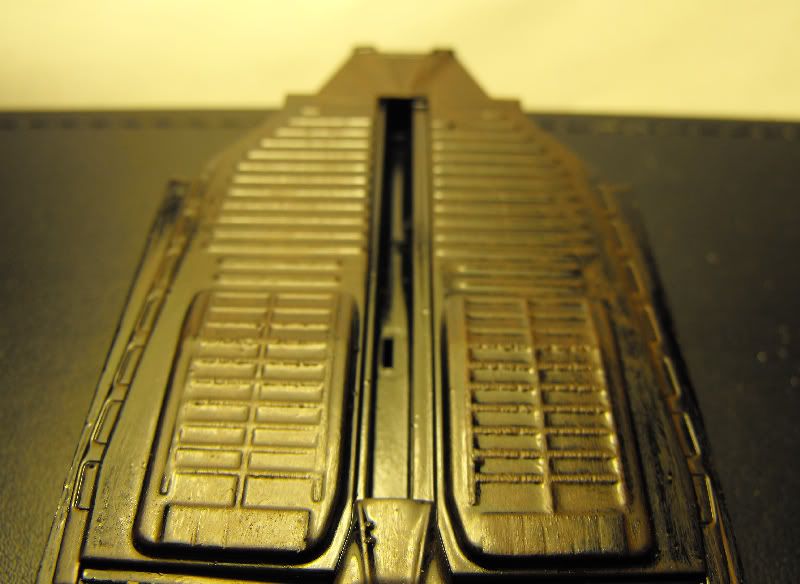

some interior work. had to narrow the front spare wheel well to clear narrowed beam.
and put some thin styrene to cover some spots. made rear seat grooves deeper and rear panels have lines to resemble some kind of paneling.
http://i136.photobucket.com/albums/q192/TRD4AG/vdub/DSCF1172.jpg
had to get some styrene rods to remake the roof rack. other idea failed.
http://i136.photobucket.com/albums/q192/TRD4AG/vdub/DSCF1191.jpg
smoothed out the back area some more, but had to add more putty. more on that later.
http://i136.photobucket.com/albums/q192/TRD4AG/vdub/DSCF1193.jpg

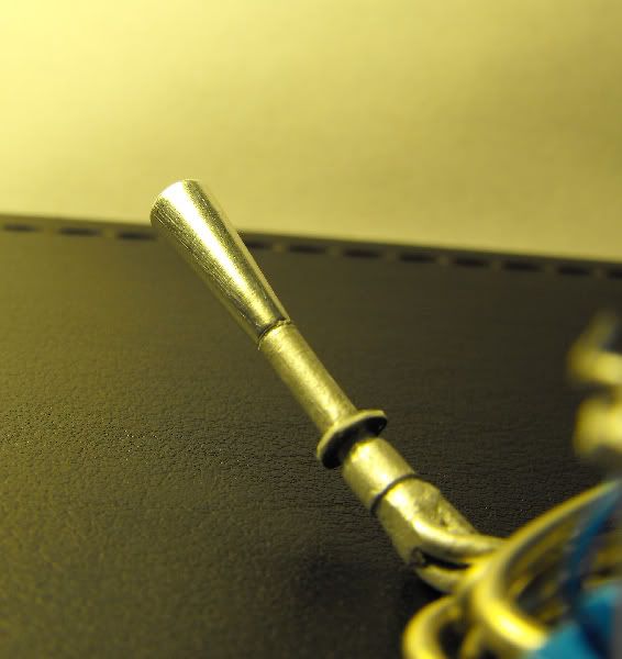

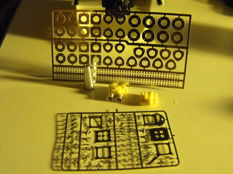

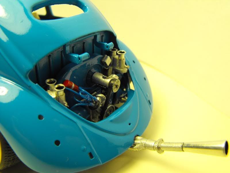

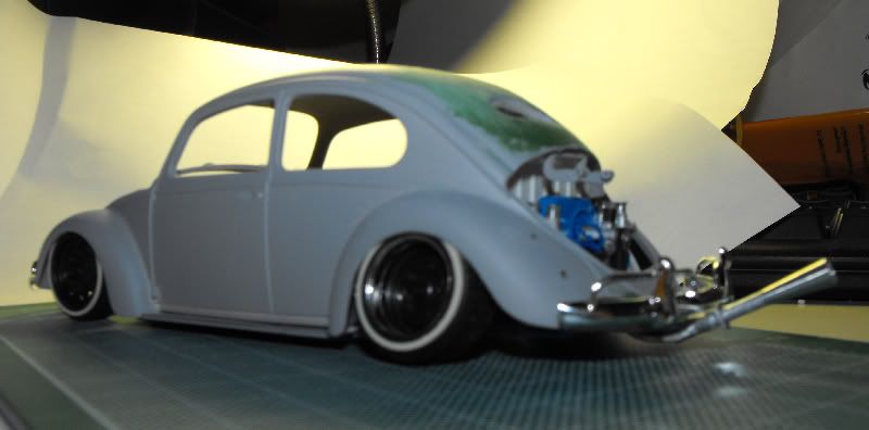

engine detail added. about 90% done.
http://i136.photobucket.com/albums/q192/TRD4AG/vdub/DSCF1235.jpg
http://i136.photobucket.com/albums/q192/TRD4AG/vdub/DSCF1236.jpg
http://i136.photobucket.com/albums/q192/TRD4AG/vdub/DSCF1238.jpg
http://i136.photobucket.com/albums/q192/TRD4AG/vdub/DSCF1237.jpg

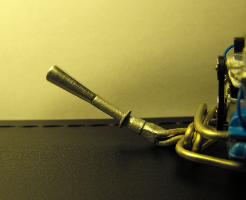

i made the header out of 1/16 solder, had to solder/melt the ends where it came together to make it stay in place. then added the stinger muffler. added spark plug wires, there's a lot of blue in there. but that's how the cali bugs do it, color match. :D
i need to go to the LHS to see if i can get some really thin styrene rod to make my linkage. can't seem to make the metal rods stick together. :roll: oh well. i need to get moving on this thing. next will be the interior. thinking of a ivory interior w/blue piping on the seats. what do you guys think?
hope to spray the chassis black this weekend and do some more sanding.

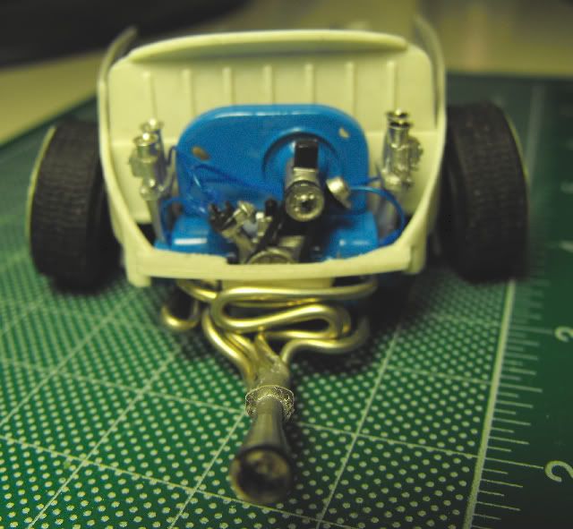

here i have a few of pics of some dry fitting. had to see what it will look like.
had to modify the engine bay a bit to fit the engine with carbs

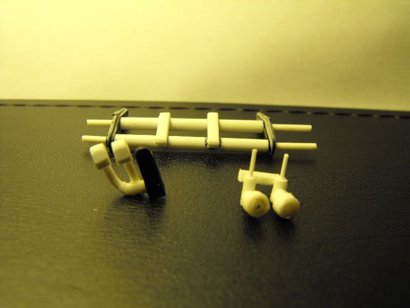

and made these. anyone want to guess what they are? clue, w/out them it won't stop or activate the clutch. :feedback:
http://i136.photobucket.com/albums/q192/TRD4AG/vdub/vw1269copy.jpg
http://i136.photobucket.com/albums/q192/TRD4AG/vdub/vw1271copy.jpg

Ferrari TR
03-31-2009, 10:11 PM
Brake and clutch masters.

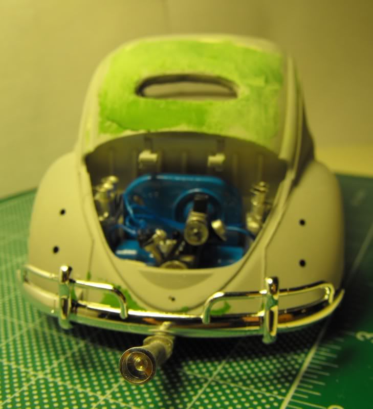

Don't know where the stinger came from, but I'm guessing that it is turned aluminum? If so, a little bit of time with some superfine sandpaper (or a polishing stick) would remove the cutter marks, and bring it to a terrific, even, chrome like shine. :sunglasse

mpwr: your right, it's turned alum. from mr model. i'll give it a shot w/the other one i have. if it turns out good ill replace it or do the same. thanks for the info.

I didn't want to offend you if you (or someone you knew) had done the part- but as a machinist, I can tell you that it's a very careless finish. Likely done on a lathe turning at the wrong speed, or with a dull cutting tool, or very possibly both. It should have been smoothed and polished on the lathe.
But a little work by hand will clean it up very nicely. Get some fine sandpaper (maybe 1500, and then 2000) and tear yourself off a smallish piece -say 1 x 1/2 inches. Wrap it around the part, and twist the part in the paper to sand it smooth. After the grooves are removed, you can polish it- any decent polishing compound (Tamiya or the like, or even toothpaste) will will bring a really nice shine to it.

mpwr: trust me bro no offense taken, i like the advice. im still basically a newbie. i thought that it should have been shinned on the lathe. it's been years since i've touched a model and it's actually the first time i use this type of detail. i've only built them oob. so any advice, tips, and criticism is good.
i do have an extra piece to do the work. practice makes a better modeler.

mpwr: took your advice, and well...it looks waaaay better. thanks for the help.

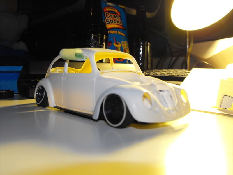

i'll be posting pics up by monday. i've decided to re-due the front suspension.

Machined aluminum is something of an 'exotic' material in car modeling. Many experienced builders haven't used it, and therefore aren't sure what is (and isn't) possible with it. So it really has little to do with you being a 'newb'. Without some experience or advice it's hard to guess what can improve a new material, or what will damage it. But it is good that you are finding advice useful. ;)

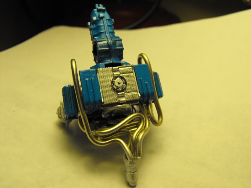

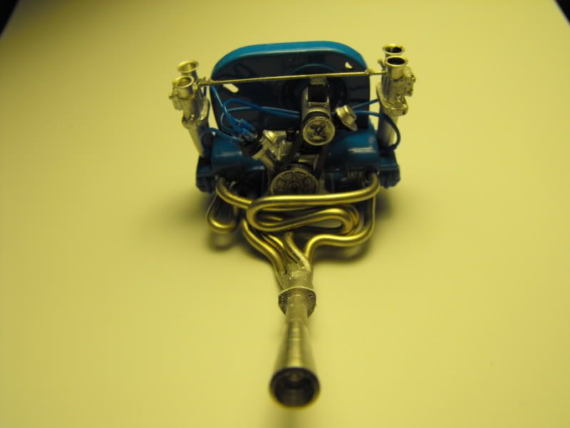

heres a little update, fellow modeler gave me some advice (thanks :iceslolan mpwr) on how to polish up the exhaust tip. so heres the best i was able to do on such a small piece. index finger and thumb were pretty tired. :D
http://i136.photobucket.com/albums/q192/TRD4AG/vdub/vdubexhaust2.jpg
http://i136.photobucket.com/albums/q192/TRD4AG/vdub/vdubexhaust.jpg
here's the bottom of the pan, some muddy effect, scrapes from pan scrapping. :wink:
thinking of adding some silver to add some contrast. let me know what you think.

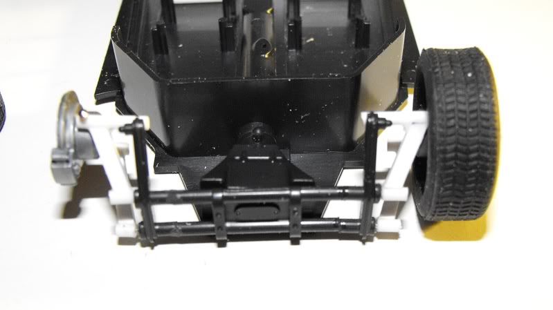

and i decided to re-due the front beem, i didn't like the hacked up look on the old one. still not happy with the out come, but time is running low for me. there's also my new pedal assembly with brake and clutch cylinders.
http://i136.photobucket.com/albums/q192/TRD4AG/vdub/vdubpieces1.jpg
still working on the body, the interior needs some paint and i should be done soon, i hope :D

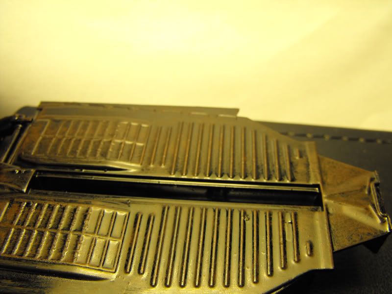

Looks great, very nice improvement. :sunglasse
the only thing that i have an advantage on is that i'm mechanically tuned and really have a passion for cars.
That will take you a loooong way in this hobby. ;)
