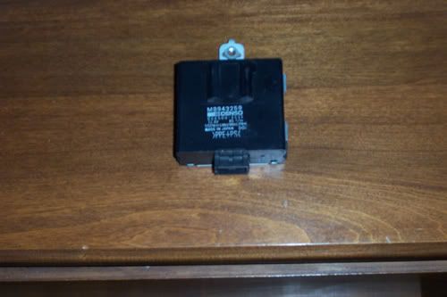

i THINK i found the flasher unit...heres a link to a picture of what i found and pulled out...
http://i108.photobucket.com/albums/n23/silque_1/flasher2.jpg
does that look right?
and if so, i just went to autozone and advance auto, and then spent quite a bit of time looking on the internet, and cant seem to find a replacement...any ideas as to where i might find one?? thanks!!!

97GSTspyder
01-08-2009, 01:18 AM
Part # MB943259
I got that from zooming in on the pic you posted. Typed it into google, and it IS the turn signal flasher relay.
As far as finding one, if you can't get one at a parts store, then you'll probably have to go to the dealership.
97GSTspyder
01-08-2009, 01:20 AM
Actually, I take that back. If worse come to worse, I have an extra one from the Spyder I can pull for you that works. Let me know.
