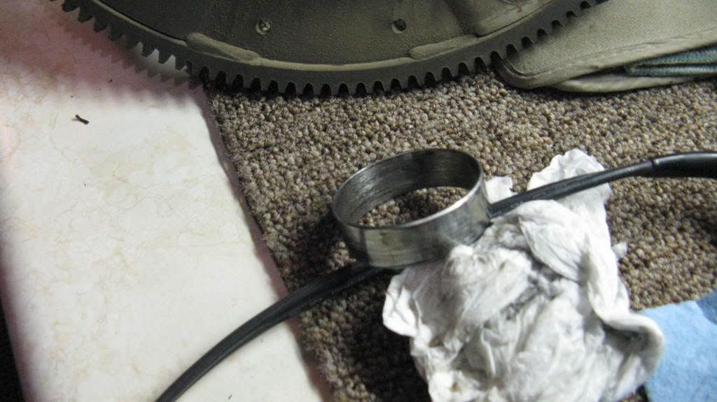

so the flywheel was replaced front bushing front seal in the pump and the converter. here is a pick of the bushing. so time will tell if we got i right this time. the car is running a 100% now. just the labor the hash out at the gm dealer.:rolleyes: http://i242.photobucket.com/albums/ff306/463_photos/CapriceClassicNov08105.jpg
silicon212
01-09-2009, 02:10 AM
Wow. So, they did replace the converter? That's good, otherwise you will be here again.

[quote=463]so the flywheel was replaced front bushing front seal in the pump and the converter. here is a pick of the bushing. so time will tell if we got i right this time. the car is running a 100% now. just the labor the hash out at the gm dealer.:rolleyes:
there is a TSB about this, that I found when you posted this...that is why I stated bad pump seal high miles means torque converter needs replacement..the use of washers is a no no....they tried to bypass a known issue....
a contaminated torque converter can cause higher pressures causing the seal to blow..
