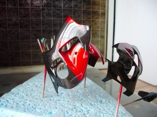

I usually apply 1 light tack coat, allow 5-10 minutes drying, then a full wet coat but with a little extra thinner added to the mix, 5-10 minutes of drying then another full wet coat, again with a little more thinner added to the mix.I wait for 10 minutes have a look at the finish and if I'm satisfied I leave it at that to fully harden.Sometimes I may apply a third wet coat but only if I'm not satisfied with the finish I had after the second wet coat.When I mention adding a little thinner to the mix it's usually no more than a few drops from an eye dropper.Don't over thin too much or you may get runs.
It's pretty forgiving stuff though usually.
Normally after 2 wet coats it looks like this
http://i17.photobucket.com/albums/b61/stevenoble/Hayabusa-firstdecals008.jpg
I have heard some people say the 2K looks too thick and glass like and looks unrealistic, but if you keep the coats down it looks pretty good I think and is nice and tough as well.
