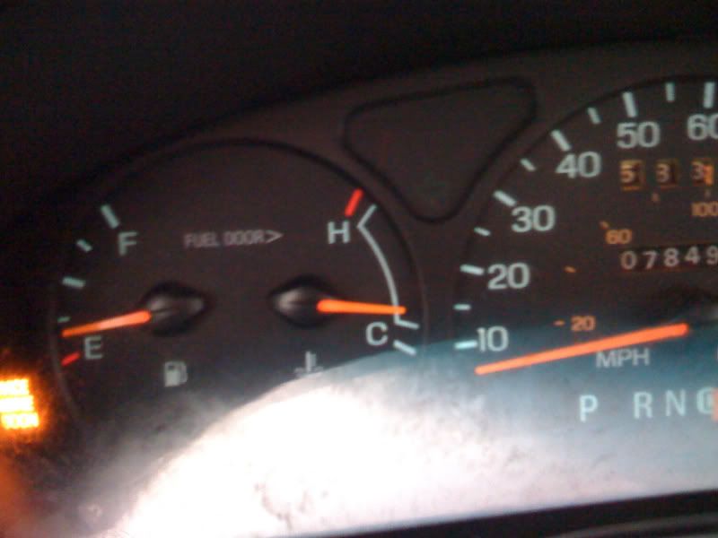

My temp gague is reading low even after being on for a long period of time. It only gets up to the middle or operating temp if it sits and idles for about 10-15 minutes. Then when I start driving it gets real low again. The heat also cuts in and out as it pleases, most of the time not getting very hot. What could be the problem?
http://img.photobucket.com/albums/v163/RoB51988/0af00bc5.jpg

The Service Engine Soon light is glowing pretty brightly, have you checked for codes?
Have you checked the level of the engine coolant level or had the cooling system serviced recently?

That could be, but it could very well be a stuck open thermostat or one that no longer opens and closes as it should. It is also possible your problem could be related to a faulty radiator cap or the pressure releasing cap found on the overflow tank which would be in place of a radiator cap. That is, there is no cap on the radiator. I'd go ahead and replace it, as it doesn't sound right loosening like that and see if that fixes things as it is the easiest first fix. Make sure that what the cap screws onto is not boogered up as that may be leaking and responsible for it loosening. Without a tight seal, the coolant won't return to the radiator when it cools. If you are getting air into the cooling system, this definitely could be the source. Make sure the radiator is completely full and put a little extra coolant in the overflow tank above the cold line. Then run it several times to see if that gets it. If not, then replace the thermostat. When doing that, you will need to be sure you work out all of the air introduced by the repair. If there is an actual rad cap, I like to directly top off the coolant there if it is low and only when cooled off as it gets the air out faster and the coolant in faster.
I thought the coolant temp in your pix was about what is on my Taurus and Windstar, both 95s with the 3.8 engine, but I don't know what year and engine is your, so I don't know if it is a fair comparison. Once my, and for that matter, most all vehicles get to normal operating temp, the temp doesn't and shouldn't fluctuate too much while driving. While not moving, the lack of air moving through the radiator from car movement greatly diminishes the cooling and will definitely raise the temp guage reading until the electric fan(s) kick on until the temp returns to the normal temp on the guage. I kind of doubt it, but if the fans are coming on too often, you can have excess cooling, but from what you have described, I don't think that is your problem. Let us know how it goes.

Its a 96 Taurus GL 3.0 . I only have an overflow tank. I just did the head gaskets over so I replaced the thermostat and overflow tank cap at the same time the gaskets were done. I've already gone back to AutoZone to get another replacement overflow tank cap because I thought the first one was faulty. The second cap I got did the same exact thing. I would tighten it down and then the next time I'de go to check on it, it would be loose and come right off easily. The only time the heat gets really hot like its supposed to is when the car has been running in park and the temp gague is a little passed the middle of the operating range. When I drive and the cold outside air gets into the engine area it goes right back down to around where it is in the above picture.
I live in Boston and I took it down to New York City yesterday. Its about a 3 hour ride and the whole time on the highway the temp gague stayed low like in the picture. But once I got into the city and traffic it seemed to get into the middle or higher of the operating temp area. The car ran fine the whole way. The heat wasnt as hot as it should be but it was decently warm. I have a Contour that once it runs for about 10 minutes the heat is unbarable on high with high fans. I had the Taurus on the hotest it would go on high fan but it wasnt bad, it did get hot in the car after a while and I did have to crack the window a few times.

I have a 96 model and my gauge looks exactly like that at normal running temp, i think they just read that way
