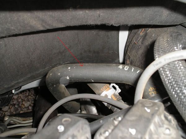

Thanks for the response. Just to be sure, does the red arrow point to the correct hose I want to tap into?
http://img.photobucket.com/albums/v495/megaman590/PC170246.jpg

I don't have my son's Alero to look at since it is in New York but it looks correct. The return line is the one that loops back over to the throttle body area and then over to the water pump through the black metal tubing. Pressure goes from the output of the water pump directly to the input at the heater core. When I get a chance I can double check the GM Alero factory service manual but that won't be until I get home after work.

Based on your pic that is the right hose which is the heater core outlet. Of the two ports you see at the firewall which go to the heater core left is outlet (return) and right is inlet (pressure).
