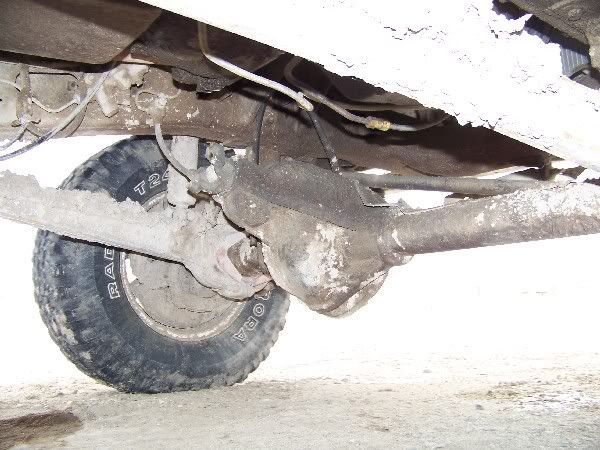

my front axle on my 1976 ford f150 is pointing upward at the cab. is it made like that or is there something wrong?:headshake

Can you post a picture? Did you buy the truck this way? Sometimes, especially on older trucks, some people made home-made lifts that may not be safe.
The twin-I-beam front end on yours often requires dropped beam brackets to work safely when lifted. If someone just installed longer springs, it may not be completely safe.

http://i202.photobucket.com/albums/aa304/PHAYS/023a.jpg
http://i202.photobucket.com/albums/aa304/PHAYS/019a.jpg

Okay, those pics make a HUGE difference. That is not a twin - I beam front end (which is a kind of independent front suspension). It looks like a very straightforward solid front axle, and has none of the twin I bean lifting issues.
Ford used both systems in their 4wd trucks for many years.
I would say it's not the axle that's the concern, but the pinion shaft,(where the front driveshaft should attach), correct?
That angle was done to reduce the risk of the front driveshaft binding, with the lift that you have. So long as the front driveshaft turns freely, you should not have a problem for low-speed 4wd driving.
High speed, highway driving in 4wd may produce some harmful vibration from the front shaft, due to incorrect U-joint phasing. However, most old, part-time 4wd systems were not built for highway use. So I suggest use 2wd only for higher speed driving.
