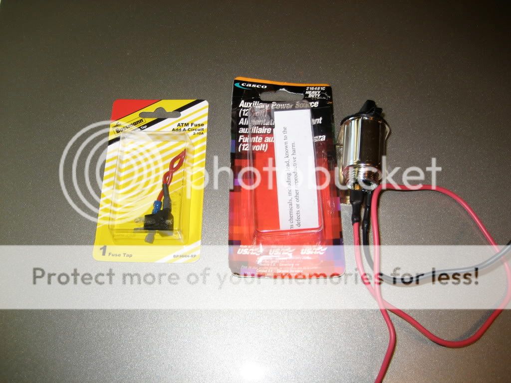

Just wondering if anyone has ever used these products. Littelfuse Add-A-Circuit Fuseholder for Mini Fuses or Wirthco Fuse Block Add-On Circuit Tap #30003.

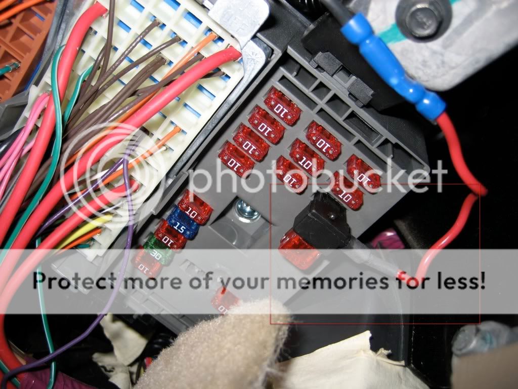

These are the items I used to make a SWITCHED power source. I went to the fuse box under the glovebox and found a switched fuse. I then piggybacked the add a fuse to this power source. I then plugged in my auxiliary power source and mounted it to a dash location. You can buy theses items at Auto Zone.
