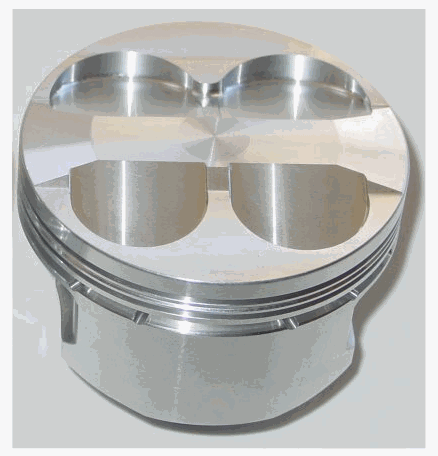

High compression piston 12.1:1

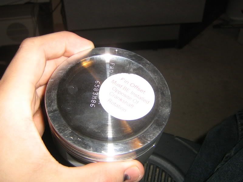

Low Compression Ecotec Pistons 8.5:1
http://i6.photobucket.com/albums/y222/dogmoo/IMG_1514.jpg
Lower the compression ratio, the deep the dish gets. The higher the compression, the dish goes away and relief cuts are made for valves.
