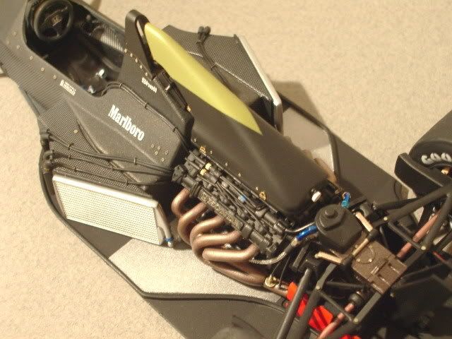

Thought I would offer a few examples.
Benetton B192 engine painted with Tamiya Acrylics
http://i17.photobucket.com/albums/b61/stevenoble/Benetton%20B192/IMGP4614.jpg
McLaren MP4/5b mixture of Tamiya, Vallejo and Alclad paints, carbon decal
http://i17.photobucket.com/albums/b61/stevenoble/McLaren%20MP4%205B/IMGP3477.jpg
