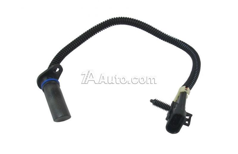

OK, I drilled out the top part of the sensor, down to just below where the o-ring is. The bottom part of the sensor is still in the hole, the section below the blue o-ring.
http://images.1aauto.com/CPS/1ACPS00007.jpg
This thing has to be really gummed up. I drilled another 1/8th hole into the bottom part and put in another #8 screw, still no luck, this thing isn't budging. The sensor should be a loose fit, the only interference should be the o-ring, since that's now gone, what the heck is holding this thing in.
