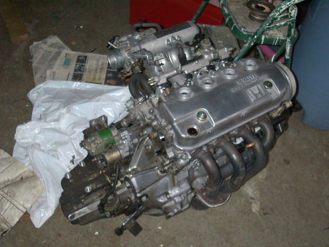

that looks good Marc-OS, heres what mine looked like, i think this was day 2 or somethin so it wasnt finished, it was like day 4 i gave up hehe

how do you get in the corners and around the letters good? Im doing it on a ZC valve corver so theres a shit load of edges and corners. I have a dremel tool and wire brush attachments, would that work good?
