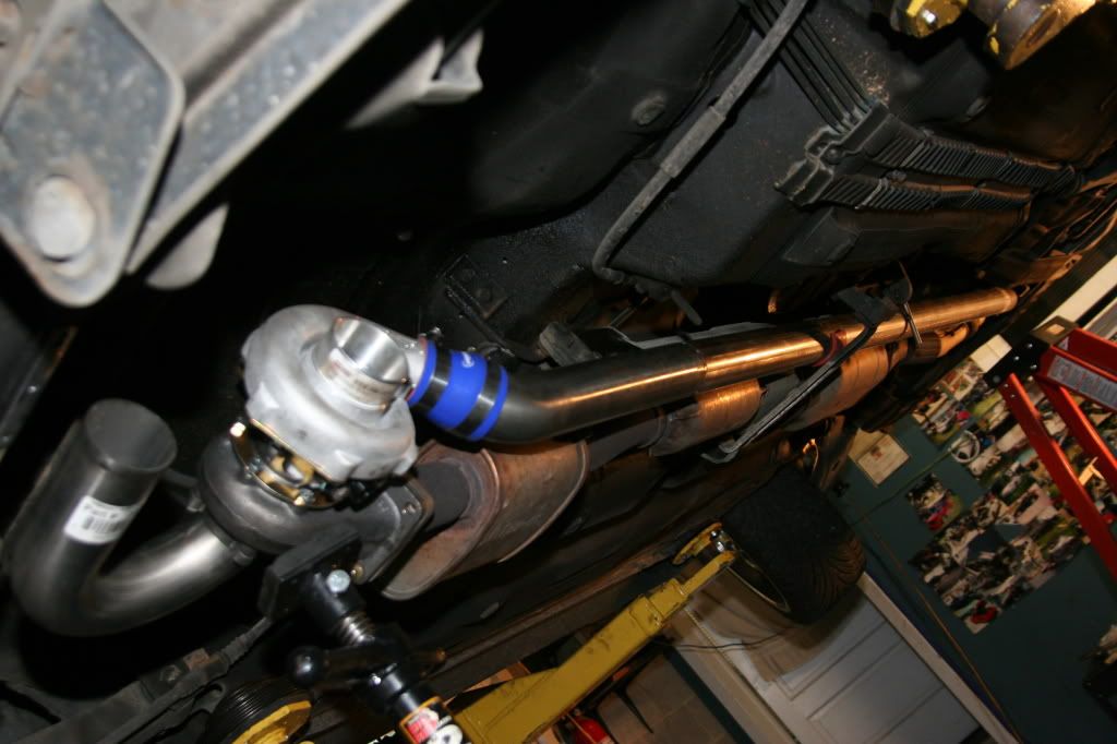

STS Universal kit, all custom built by us here at
AUTO VELOCITY
http://i173.photobucket.com/albums/w51/toddrs93/stscar004.jpg
http://i173.photobucket.com/albums/w51/toddrs93/stscar021.jpg
The end result was about 100 wheel horsepower gain at 6-7 pounds of boost.

toddrs93
11-09-2008, 12:42 PM
My biggest worry is the oil pump they supplied. Its an in line booster just after the turbo on the return side, I think we are going to look for a better one.

toddrs93
11-19-2008, 06:55 PM
The downside is pressure loss.
Yea we found about a 2psi loss of boost from the turbo to the engine so you have to compensate for that. hers the claims directly from STS:
