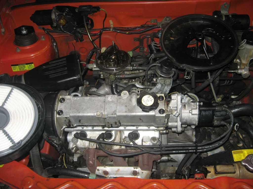

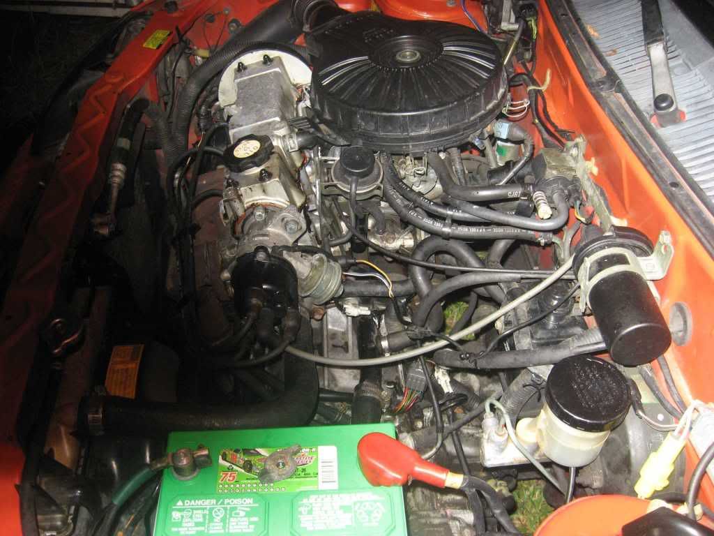

First thing I have to do is figure out if this is a fuel injected or carbureted motor. It is a 1991 and here are a couple of pictures of the motor. I think that's a carburetor behind the valve cover. Does that mean this motor's been swapped or did they build some non injected Metro's in 91?

The head gasket is bad. Once the thermostat opens up the radiator would foam and lose coolant through the reservoir. I suspect that's why it eventually overheated for my friend. He didn't bother to check his coolant level everytime he started it... :wink:.
Also there was quite a bit of fresh clean oil in on top of that carburetor and in the bottom of the air cleaner housing.
My friend wants to spring for a reman head so I just have to figure out what head to order.

That's a throttle body. There was never a carbureted Metro, they're all fuel injected.

See that little black device hovering over the intake shooting fuel into it... Thats a fuel injector. That oil in the filter housing gets sucked in through the valve cover. It's pretty normal. Just wipe it out if it's excessive. You may want to check out the water pump. They go bad in these things and can also cause the problem. It may have also caused the head gasket to go too.
