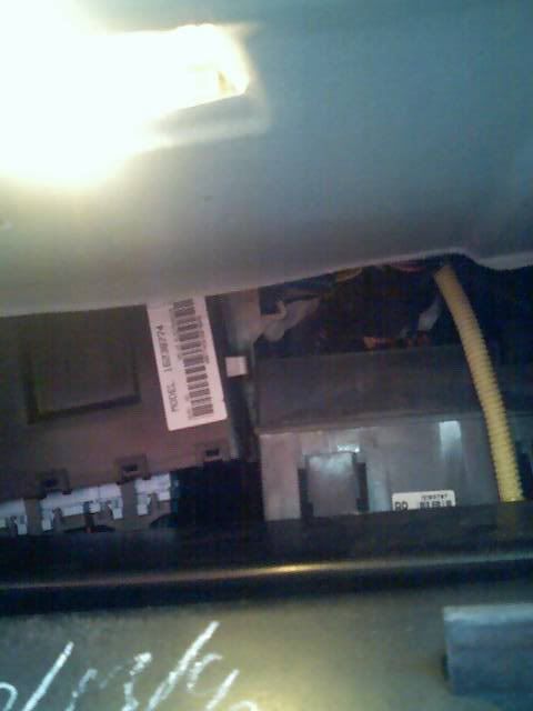

temp door arm is external- as well as actuator- should be white plastic- with adjustacle threaded rod- very easy to see on top of HVAC case-- did you drop the glove box (swing it down) to the floor? To get a better view?

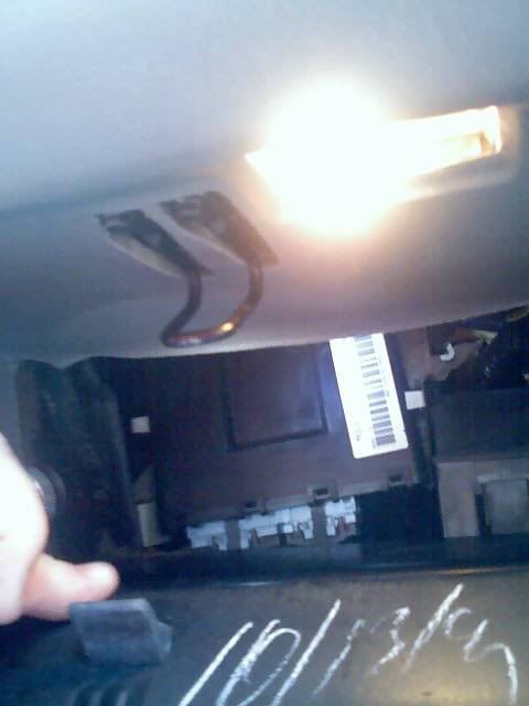

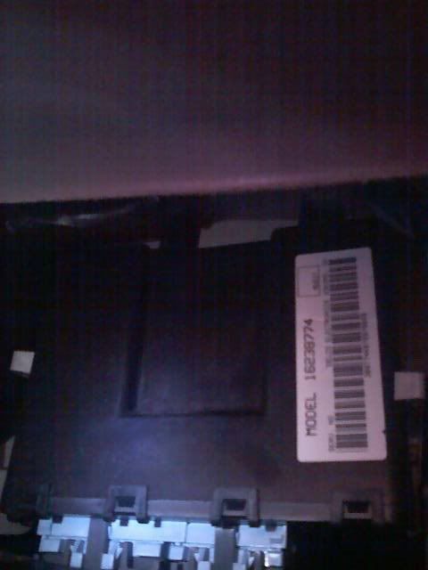

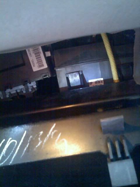

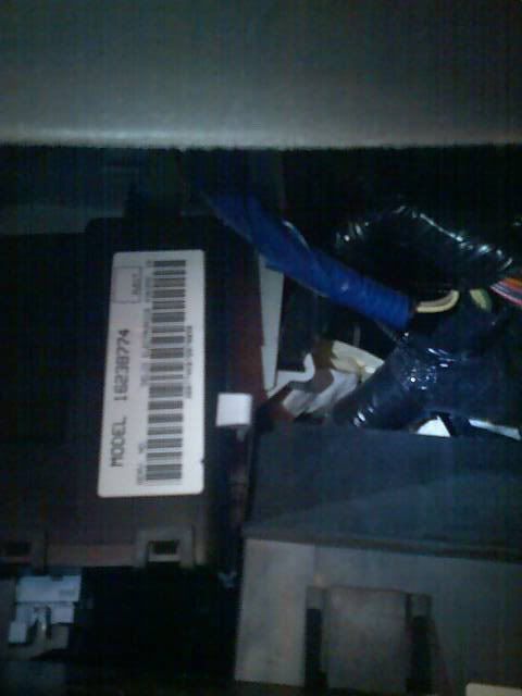

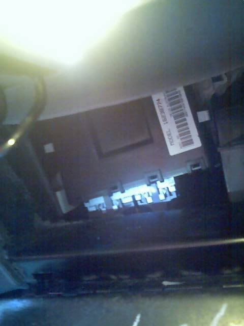

cutlass1972
10-17-2008, 11:15 AM
I am not seeing this at all, do I need to start removing stuff to get to it? Here is what I am seeing

brcidd
10-17-2008, 11:22 AM
Yes- You have to get back to the HVAC case- looks like the BCM is right in front- unclip it and let it drop to the floor- hopefully you have the hush panel out above the passenger footwell....

cutlass1972
10-21-2008, 11:26 AM
ok, I finally got in there. Mine is NOTHING like yours guys. Mine actually has a motor that mounts to the side of the heater box that turns a white plastic knob that sticks out. It mounts right to the knob though as opposed to some actuator linkage. The motor only controld the passenger side hvac, once I removed the motor then turned the white knob by hand until there was heat coming from driver and passenger side the passenger gets whatever the driver gets. Now I need to find a replacement motor assembly.
