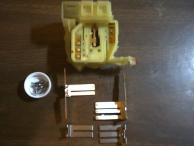

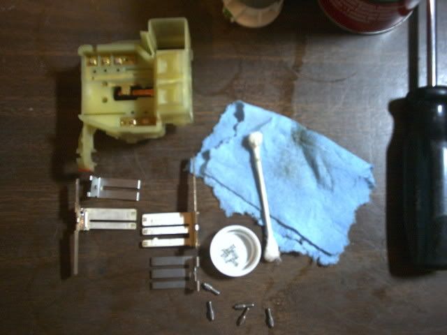

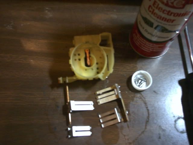

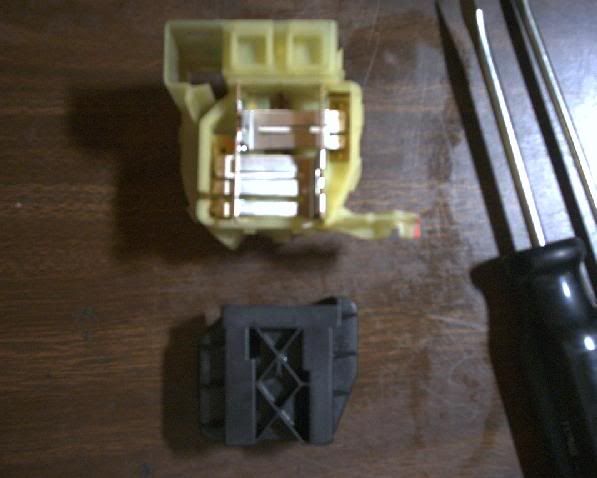

Cleaning the ignition switch, if your security light doesn’t let you start the car then this may be part of your problem. I did it on mine and the light is off and it didn’t blink again, no starting trouble. The Passlock security system is still working well so I won’t be disabling Passlock soon.
Once it’s apart from the assembly you’ll have to pop the back out so
2 flat heads, 2 q-tips, bottle cap, and a tough napkin
Some electric cleaner maybe WD-40 but dry it
You may see some black gunk on the contact points
Take it apart and clean all the metal pieces, except the springs I pulled on them to give it some strength.

Thanks for the detailed pics and steps. Now I won't be scared as much to do this on my own:)
