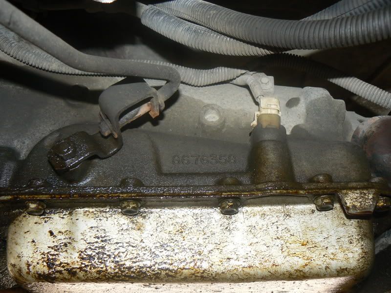

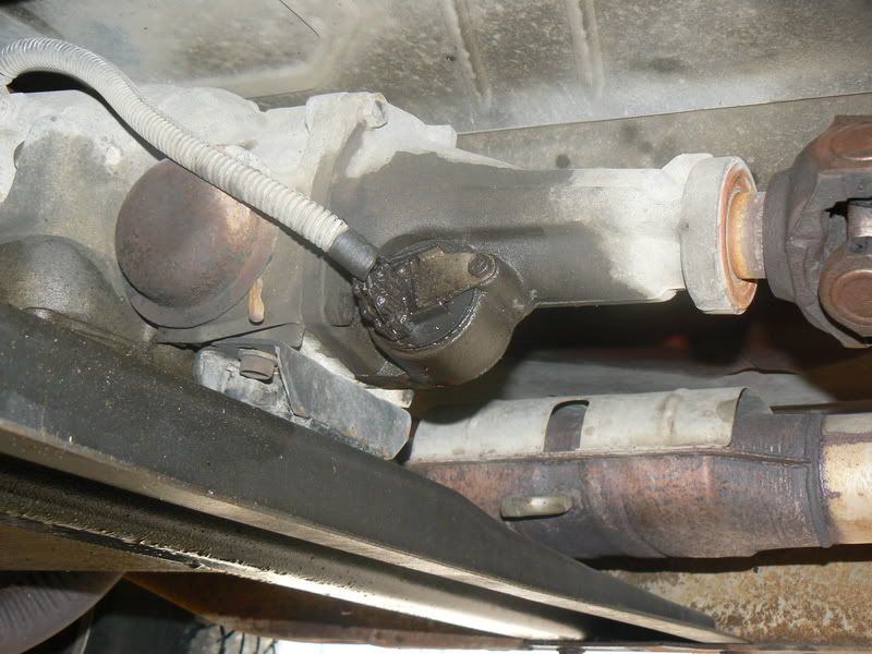

Anyone know what these two items are? Could either be causing my problem?
http://i119.photobucket.com/albums/o151/tera2/P1030794.jpg
http://i119.photobucket.com/albums/o151/tera2/P1030795.jpg

2000CAYukon
10-07-2008, 03:54 PM
The first one is the vehicle speed sensor.
The second picture, it could either be the pan gasket (most likely) or the shift shaft oil seal.
The pan gasket looks to be leaking quite a bit and should be replaced (since you have to drop the pan, replace the filter).
I am not sure if the VSS has a gasket or O-ring that can be replaced. Maybe someone else can let us know.
EDIT: Looking at a picture of the speed sensor (http://198.208.187.182/internet/ViewPartImage.jsp?acdelcoPartNumber=213-194) there looks to be an O-ring that you might be able to match up at a part store to replace it.

jdmccright
10-08-2008, 10:12 AM
If your tranny was low on fluid and that's the reason for the malfuncton, then these two (or three) leak sources could be it. But it would have had to have been leaking for a long time between checks. I do not see any leakage coming from the output shaft seal. Also, check all the transmission fluid hoses and conections to the radiator for leaks at the metal crimps...leaks here are common, too.
