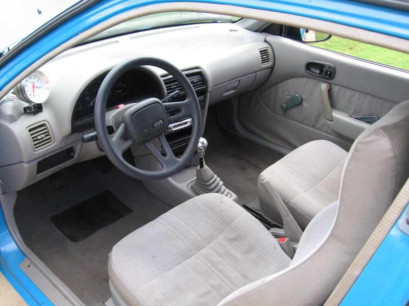

Why not replace that steering wheel with one from a Suzuki Swift. They are much sportier and fit perfectly!
You can go from this...............
http://i83.photobucket.com/albums/j314/kyles92z34/92%20Geo%20Metro/IMG_2300.jpg
To this.................
http://i83.photobucket.com/albums/j314/kyles92z34/IMG_2594.jpg
I think after all the fuel that car has been saving you, a nice new steering wheel would be cool for "The Phoenix" :cool:
