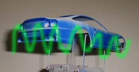

This is what they mean by mist coat. (ignore the green lines.)
http://i21.photobucket.com/albums/b258/hirofkd/550%20maranello/p7270017.jpg
FYI, the photo is from this thread: http://www.automotiveforums.com/vbulletin/showthread.php?t=433893
Notice the paint doesn't hide the primer at all? You basically end a painting (or clear-coating) session like this, wait until the paint dries, then repeat the process several times.
Paint contains solution, and if you apply too much, the solution will attack the underlying paint (or decals). The idea of mist coat is to let the solution "evaporate" before it begins affecting the underlying coat or decal. Once you build a protective layer, you'll be able to start applying a bit more at a time, but I don't recommend doing a full wet coat regardless. This method will take time, but will also reduce the risk of ruining your paint job.
