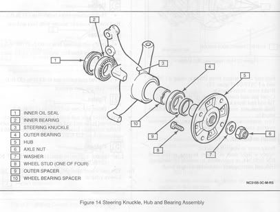

Well, bad bearings can be noisy ... usually a growling or grinding noise. You can jack up the car and check for end play in the hub, spin the wheel see if you hear or feel anything.
To change the bearing you'll require a press - although my manual shows bearing being installed with a hammer and special driving tool - my preference is a press. The thought of hammering on bearings makes me cringe :eek:

When I did mine this was the basic order that I did things in:
-Remove wheel
-Remove Brake caliper ( hang up out of way)
-Remove axle nut ( 30mm socket, unstake nut with a punch)
-Disconnect tie rod ( remove cotter pin spin nut till its flush with the end of threads and use a hammer to pop it free ... the nut prevents you from damaging the threads.)
-Remove 2 strut to spindle bolts ( I broke 1 of mine, so it might be an idea to have new hardware before hand. I got new hardware from Fastenal 12-1.25 x 55 metric bolts. )
-Remove ball joint stud nut and bolt (10-1.25 x 50 metric bolts).
- Remove spindle/hub assembly.
- Press hub from spindle.
- Pull outer bearing from hub. ( needed a 3 jaw puller )
- Drive out inner bearing from spindle with hammer and punch.
- Press new outer bearing onto hub ( ensure outer spacer is installed)
- Press new inner bearing into spindle.
- Press hub into spindle ( ensure inner spacer is installed first, and be careful not to push out inner bearing when installing hub.)
- re-install hub/spindle assembly.
- Install grease seal over inner bearing
My car is a 92, but I think it should be pretty much the same as yours. Start to finish it took me about 3 hours ( with a long pause in the middle while I waited for new hardware :icon16: )
Your mileage may vary depending on what tooling you possess etc. I have a shop press and a large assortment of different sized pressing adapters ... If you don't have the right tools, beg, buy or borrow them cause nothing is more frustrating than having something half apart on a sunday evening before work on monday and finding you don't have a part or tool etc.:runaround:

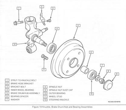

The rear bearings are a lot easier to change, remove wheel, undo nut and remove brake drum. The bearings are pressed into the drum with a spacer between. You can push the spacer to one side and use a hammer and a punch to drive the bearings out. Press the new bearings in, and re-install drum.
http://i194.photobucket.com/albums/z17/5_O_Clock_Charlie/Geo%20Metro/Rear_bearings_thumb.jpg (http://i194.photobucket.com/albums/z17/5_O_Clock_Charlie/Geo%20Metro/Rear_bearings.jpg)
