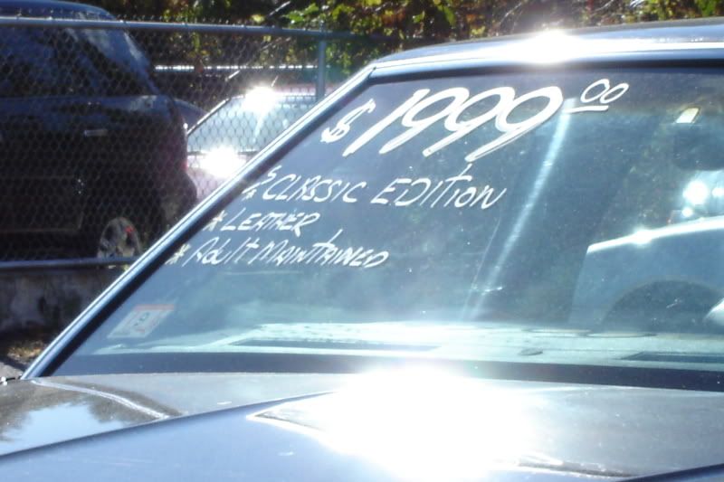

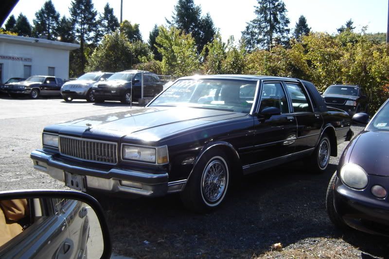

im thinking of picking this beauty up
http://i372.photobucket.com/albums/oo166/Beat88ls/DSC00597.jpg
