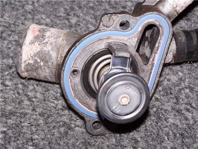

Now, I want to thank carbon02 for the pictures of the old and new thermostats. He sent them to me last night and I verified that the part I got in the mail was the new design.
The old thermostat show below has a solid bottom plate.
http://img.photobucket.com/albums/v78/LittleHoov/computer/Oldthermo.jpg
The new thermostat shown below has 4 slots in the bottom plate, apparently to allow better flow under low flow conditions.
http://img.photobucket.com/albums/v78/LittleHoov/computer/Newthermo.jpg

The older thermostat came off surprisingly easy, two bolts, and I didnt have to loosen the belt even. What was shocking is that the "old" thermostat was actually the new design. I thought "well crap", but I did notice that at least 2 or 3 of the 4 slots were clogged up with Dex-cool that had hardened..so I thought that might have been the problem.
Before installing the new thermostat, I decided to take GM's engineering a step further and I drilled two small holes in the bottom plate. Might as well let some coolant flow eh?
