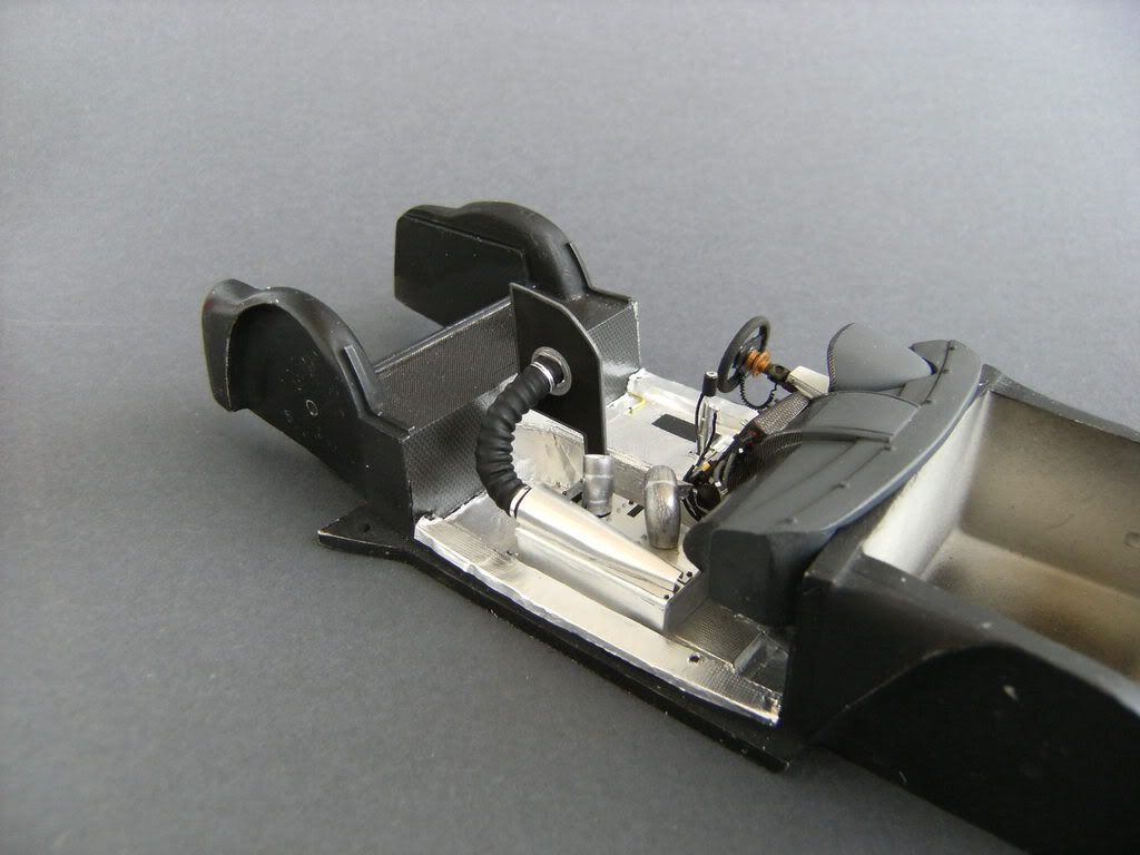

Hey Kev,
Thanks for your comment! Sorry for my poor explanation…..really…..this should be a wip!
I took a proper sheet of aluminium foil and a mesh from my former military modelling time which was used to cover air filters and / or vent openings. I then pressed the mesh onto the foil and rubbed the structure of it “into” the foil. That was done with the bottom of glass. So it is something like pressing the net on the surface of the foil.
Maybe it would work also if one would glue the mesh onto the foil and then turn it around and working it from backside. You would then have to glue the net-side on the demanded surface. I don’t know, it could be to “thick” and inelastic?!
I fixed the so structured foil into the compartment with normal plastic glue, on some edges carefully with super glue.
I hope this helps!?

Thanks jochen for the explanation of your simple but effective technique. I would have thought on pressing the foil onto the plastic surface, it might smoothen it back out, but again, your results are great.

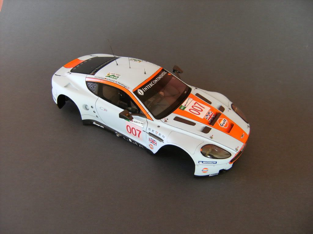

02-04-2009, 06:00 PM
Im gonna have to agree with Klutz, with all the hard work on the interior, all the details surely took ages, it would be a pity to hide your beautiful interior creations behind glass, open those doors up.
Q. are you goning to do the body after it raced at Lemams, ie with all the brake dust & covered in dirt? I saw a Top Gear (TV show) with that DBR after the race, they didnt clean it, i think AM even took it to Goodwood a few weeks later without cleaning. It would be interesting, but id still love to see it shine in that beautiful Blue & orange livery.
Amazing work so far cant wait to see more!!!! Its addictive!!!

da ashman, AHA you got me!!! Yes, this one will be shown totaly race worn like at the Goodwood show! Let's see if i can work it out to make it look like i want to interpretate the DBR9 after been flagged at the 24h race.

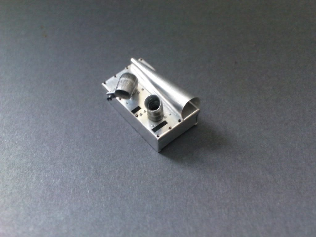

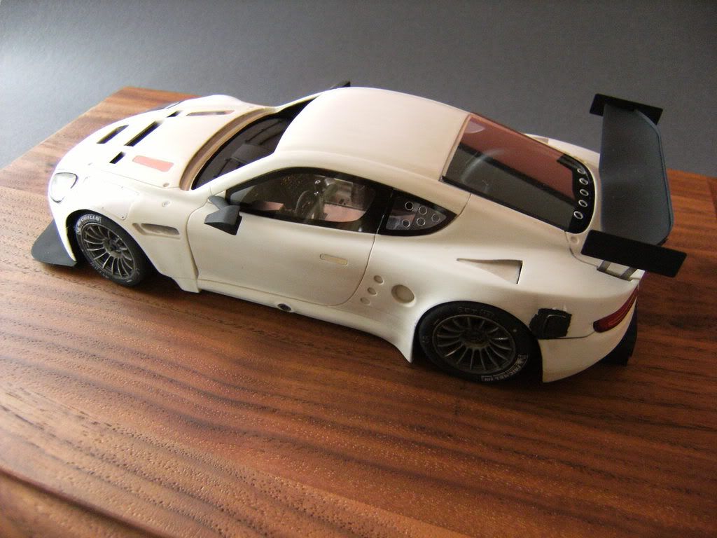

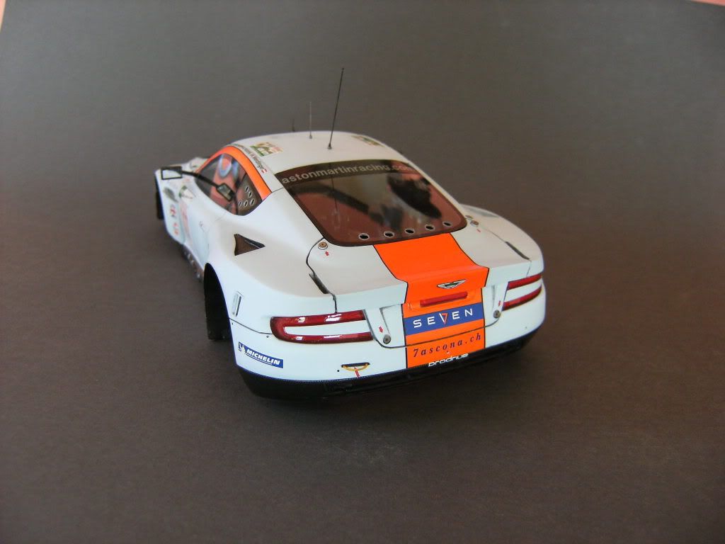

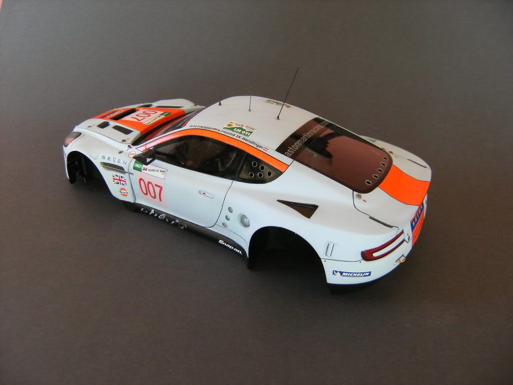

Hi all,
it seems i have kind of a flow at the moment. Things develop quite satisfying. I scratched that cooler / vent device, made that flexible air host and the small compartement in which the host is fixed by several screws and / or bolts. I have to admit that not everything is 100% in scale but as i always mention it has to look cool and proper in the model subject. So this is just another "way of mine" to show things up.
(sorry but the first pictures were made with my mobile phone thats why they are not that accurate)
http://i471.photobucket.com/albums/rr79/gulf009/DSC00750.jpg
then that little "suitcase" it looks actually like a tool box.
http://i471.photobucket.com/albums/rr79/gulf009/case2.jpg
the two parts brought to place
http://i471.photobucket.com/albums/rr79/gulf009/vent1.jpg
http://i471.photobucket.com/albums/rr79/gulf009/vent4.jpg

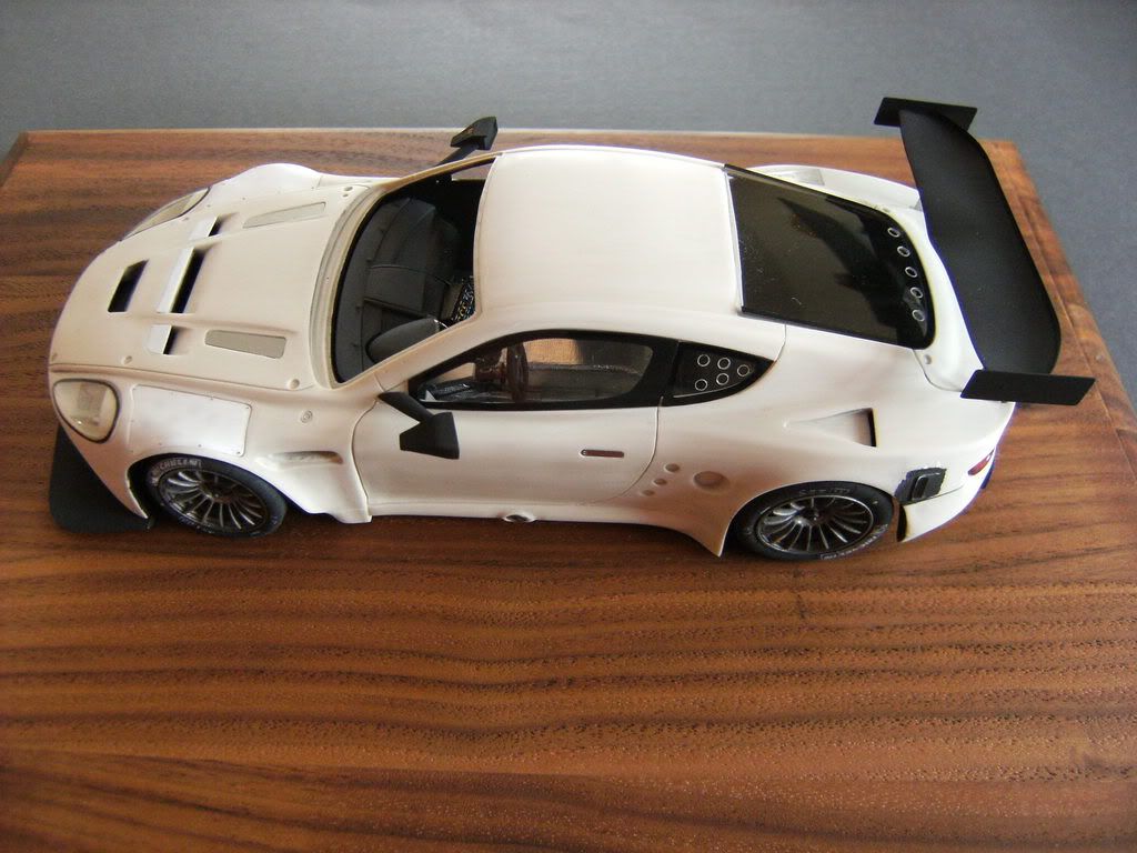

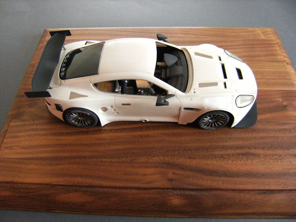

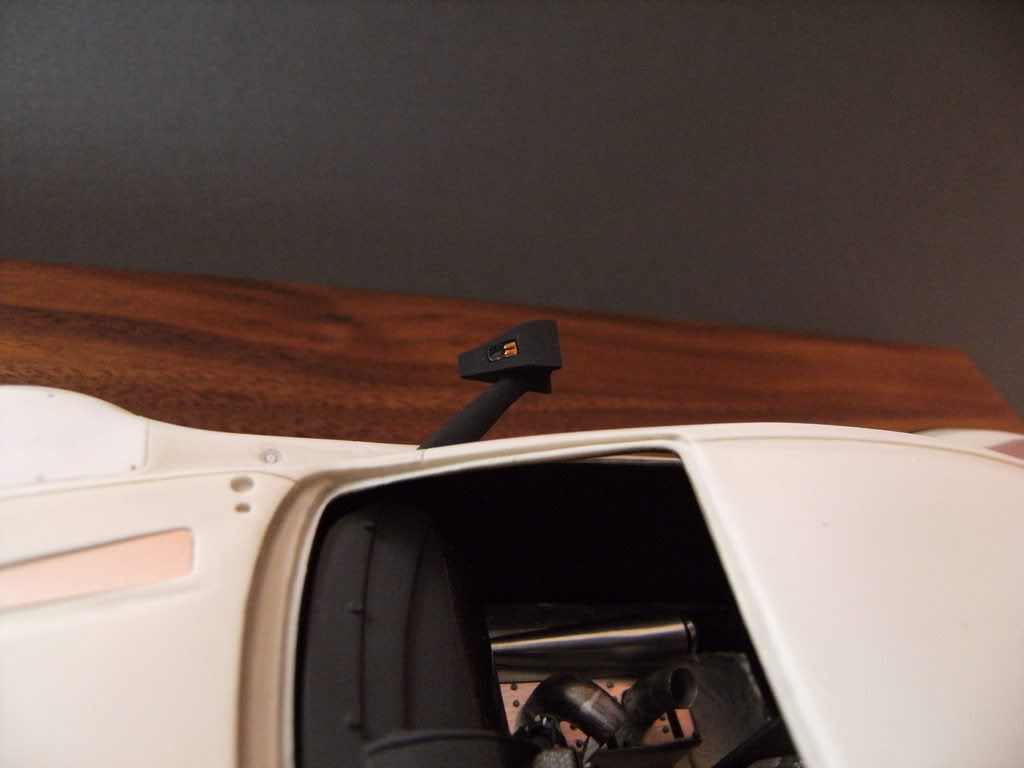

I couldn't resist i had to make a small "shoot" with some parts in place in general just to see if things fit together and to have a impression of the car. Everything is removed again to begin the colour works pretty soon.
So this is just for imagination and documentation of the DBR9 so far.
http://i471.photobucket.com/albums/rr79/gulf009/034.jpg
http://i471.photobucket.com/albums/rr79/gulf009/035.jpg
http://i471.photobucket.com/albums/rr79/gulf009/031.jpg
http://i471.photobucket.com/albums/rr79/gulf009/040.jpg
http://i471.photobucket.com/albums/rr79/gulf009/015.jpg
http://i471.photobucket.com/albums/rr79/gulf009/029.jpg
OK, thats it for now.

02-22-2009, 08:15 AM
Great work as always. Those assembled pics look promising!
Robi J
02-22-2009, 09:19 AM
Fantastic. How did you bend the cone-shaped part?
Robi :)
Robi :)
360spider
02-22-2009, 09:20 AM
Shaping up nicely! Great scratch work again!
Bartak
02-22-2009, 03:36 PM
Jochen...there`s a lot of very experienced modelers and plenty of great built on this forum. This is certainly one of them.

Fantastic work as ever :thumbsup:
What did you make the metal blower unit out of? Is it photo-etch or did you cut up some sheet metal? Or....? :)

The square unit has a base made out of a small plastic corpus made from styrene and Evergreen profiles and is then “wrapped” with thin sheet metal. The conical part is a triangle formed piece of sheet metal carefully bend over a conic file.
Dammed, I have to keep in mind to take some more progress pics. Sometimes I try and try and try and when something finally succeeds I’m too satisfied and happy to recognize that I should do some more documentation!! Sorry !!!!

02-25-2009, 01:03 PM
Oh my, what a beauty! If it weren't for that wooden base it could so easily pass for a 1:1. You continue to inspire and amaze.

Weekend, time for an update.
Hello all, i want to let you know about the actual state of affairs....;-)
The body is coloured, a mixture of FLAT white and blue of Tamiya acryls, decals are brought to place (man, the decals took me almost two weeks, some had to be pimped because these black thin lines at the orange parts above the sidewindows were completely missing..????????!!!!! So i had to improve with ultra fine cutted black 3M-tape from ScotchBrite.)
Holy ....., the orange decal session around the front air intake was a real challenge!
Some carbonwork was done, it was the first time for me to have an eye on these very special and typical racething. I want to say a BIG thanks to the man formerly known as "the saint".......;-) Thanks again for all your efforts also beside the forum!! Your hints on how to work carbon fibred areas and parts are a treasure for me.
I then gave the panel lines a very subtle wash with a very dark grey aquarel / watercolour (believe it or not, oils would be a step to "hard" from my point of view), also the fasteners were washed of course.
A short explanation about (my way of) colouring the car with flat coloures. I want to show the DBR9 after beeing flagged immediately after the 24hours longrun when the brute thing was totally covered by brake dust, films of oil and dirty rain and and and......Also thus i'm a big fan of flat finishes / surfaces (maybe a virus from my military modelling time....) i have choosen to finish it that unusual way. Later on the decals will be hidden by another coat of flat clear also. So the look might appear some strange at that actual point of the progress.
I must say that race cars have an even more impressive look with all that dirt on, but that's my personel point of view. Just to let you know about my impulsion.
ENOUGH WORDS!!!!!
http://i471.photobucket.com/albums/rr79/gulf009/013.jpg
http://i471.photobucket.com/albums/rr79/gulf009/008.jpg
http://i471.photobucket.com/albums/rr79/gulf009/012.jpg
http://i471.photobucket.com/albums/rr79/gulf009/011.jpg
http://i471.photobucket.com/albums/rr79/gulf009/010.jpg
OK, lot of work ahead , time is running.
The compartement will be finished soon hopefully (only the seat, the cage and the belts), then i have to bring the modules together and then the wheels) and of course all the final finishing weathering steps!!
Bye for now!

03-22-2009, 08:03 AM
Beautiful work, Jochen :worshippy
I totally buy into your "flat and dirty" philosophy on this build :1:
I think it will be refreshing to see a realistic looking car instead of the quasi-shiny one I did. Really looking forward to seeing the effects.

03-23-2009, 02:18 AM
Superclean job, Jochen !!!!
... just one negative point: all your fantastic job on the interior can hardly be seen now.
sjelic
03-23-2009, 06:15 AM
Absolutely fantastic, can't wait to see it nice and dirty, that is something I don't have guts to do on shiny finish :D
Robi J
03-23-2009, 06:30 AM
Your DBR9 looks terribly real yet now (apart the side mirrors, they look a bit big to my eyes). What a fantastic job...
Your former military activity is clearly evident, and for sure the final weathered result will be outstanding.
Silently admiring: Robi :)
Veyron
03-23-2009, 07:38 AM
Looks fantastic!
One thing I would do to it which would fix the one weak spot to my eyes....I would put a very thin coat of acrylic clear around the edge of the holes you drilled in the windows.
The holes make the 'glass' look out of scale in thickness....the clear will all but hide the edge therefor making it look thinner.

jochen kieslich
03-24-2009, 04:01 PM
Thank you all very much!
It's very nice to have so many enthusiasts around and to have so nice (digital) dialouges. We all should meet one day and reflect about life, modelling and which kind of beer to have next.........
Some answers in time:
@Bartak: Let's see what happens at the Sarthe, i'm soooo excited!!!!
@Micha: Kind of modelers "fate"?....BUT it's nice to know that (almost) everything is "there". If i would have had more or better reference pics depending that particular area.....i think i would have openend both doors.
@Sacha: "Nice and dirty", yes, exactly SIR!!!!!!!
@Robi: Maybe you're right, another hint for wrong kit parts, i didn't rework them because on some pics they appear real large, like small wings. I used them straight out of the kit.
@Veyron: Man, thanks for your hint, i never thought about that. I have to think about how to solve that, something came to my mind. I'll keep you informed!
@da ashman: I'll work with pastels, diluted pastels, pencils of various coloures and with the airbrush. let's go!! I'll present some pics of the used materials when finished, i promise.
@Spike2933: Thanks, i'm honoured!!!
@RallyRaider: Thank you! Absolutely, i agree, i have to be careful when finishing begins.
@Decs0105: Many thanks, very much appreciated!!! I have to say that by now i think a bit "different" about the DBR9 in that powder-blue and orange livery.......one of the coolest outfits was that of the no.59 car from Modena Motorsports in the LeMans Series 2008......but that used finish / effect would not appear on that body color. Don't get me wrong, i still love that one (of course i do)....;-)
