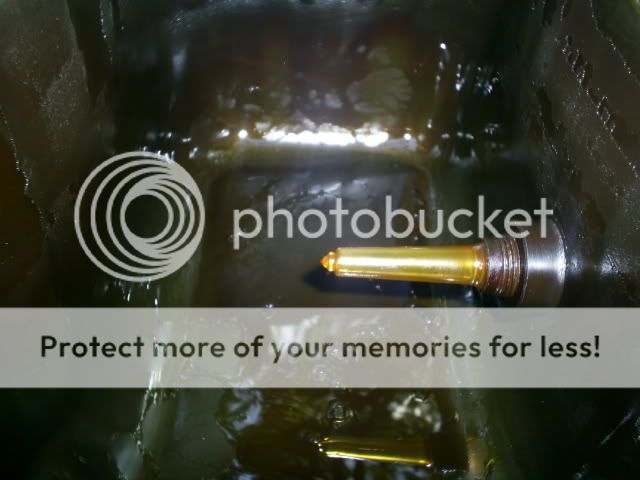

I have a leaky oil pan. I plan on changing it tomorrow or this weekend. Its been like that since I had the car but I though it was small. Plus there has never has been a drop of oil on the ground. When I changed my starter the other day I got a closer look at it and it is worse than I thought and explains why my oil consumption is so excessive. (1qt every 1200 miles)
My question is: if the pan Is leaking, when does it leak if it never hits the ground. And here's a pic of the oil pan

Obviously the oil pan gasket leaking is not the source of the high oil consumption. You'd have to see oil puddles under the car in sufficient quantity. The oil pan gasket is a common issue on SII 3800 engines but I've never seen them cause oil consumption like that. Other sources of oil leaking are the valve cover gaskets, front and rear crank seals.
But in your case I agree it sounds internal to the engine. Either piston rings or valve stem seals.
Another suggestion is check your PCV valve and make sure the o-ring seal is there.

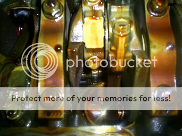

Here a pic of my engine. The cylinder wall (not in pic) still have the cross-hatches at 143k. Pennzoil only

I think my consumption of oil has went down considerable since the one side valve seal change and oil pan gasket change. I now realized that each hole in the cross hatch are represents about 0.2qt (1/5). I put .5qt of oil in after the pan gasket change it filled it up 3 lines and now after 920 miles its only down 2 holes. If each hole represents .2qt that now my oil consumption should be a qt of oil every 2300 miles now. So I'm happy.

Also looking in your pan I like what I see... Look quite clean with no metal particles... Thats a very good thing to see..

Yeah, I was pretty glad it was clean. But I did find some extra stuff in there that's not in the picture. I found some paper filter element, which I thinking is from the fram filter that was used on the car before I purchased it. I only use purelator filters. I also found so thin plastic peices and have yet to determine what the were but they were small and look like they made a ring around something.
