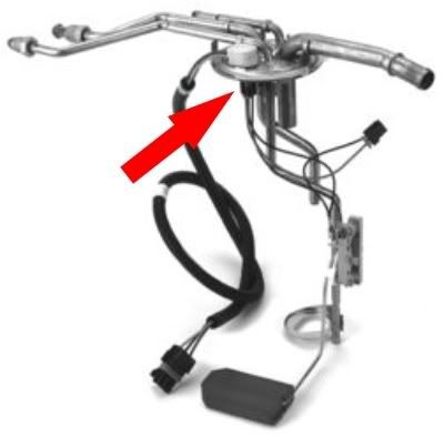

I would pull out the fuel pump and inspect the conector on the inside of the sending unit. It is very possible that this connector is burned up. The symptom you describe sounds just like this problem. Make sure you have power to the fuel pump when it stalls also.
http://i83.photobucket.com/albums/j293/airjer/AF%20Stuff/sender.jpg

The new pump doesn't guarantee you have fuel pressure. Like I mentioned before if the contacts on the inside of the sending unit are burnt up it will affect the ability of the pump to receive the proper amount of current which will effect the fuel pressure.
At cruise there is the least amount of "stress" on the fuel and ignition system. It is entirely possible that the condition is there but is not noticeable.
You need to monitor fuel pressure when it stalls to see if this is the problem if it is than it will be easier to fix if not than you have ruled out 1 possibility. Since it starts every time with ether it sounds like you have a fuel issue unless its just plain coincidence. The new ignition module is a long shot. I would try wiggling the wires at the coil first. I have seen several times where the wire will break inside of the insulator and will look perfectly normal only to have the vehicle stall when they are wiggled.
The last question is does it feel like like you forgot to push in the clutch when you come up to the stop light. I guess that direction really doesn't make any sense because if the TCC solenoid was stuck it should start and idle fine until you put it into gear and then it should stall. I guess still worth asking.
Seriously you need to monitor fuel pressure. Until we know whether or not it is good based on fact than there is really nothing else to guess at. All the symptoms and things you have done to get it started lean toward a fuel issue!

I realize its an automatic but I wanted to know if it felt like you forgot to push in the clutch right before it stalled. It was a long shot and I'm sure the answer is no.
You can find relatively cheap pressure gauges. It would be best to find one with the fitting that screws on to the GM test port. There all the same size, and this will give you the beast results for the least amount of work.
One last thought is to unplug the MAF (mass air flow) sensor and see if it drives any differently. It is quite possible that it is dirty or giving the wrong signal to the PCM and leaning things out to the point of stalling? If this improves the stalling issue I would clean it first with MAF sensor cleaner and see if that works.
I am still pretty confident that the sender in the tank is the problem!!
