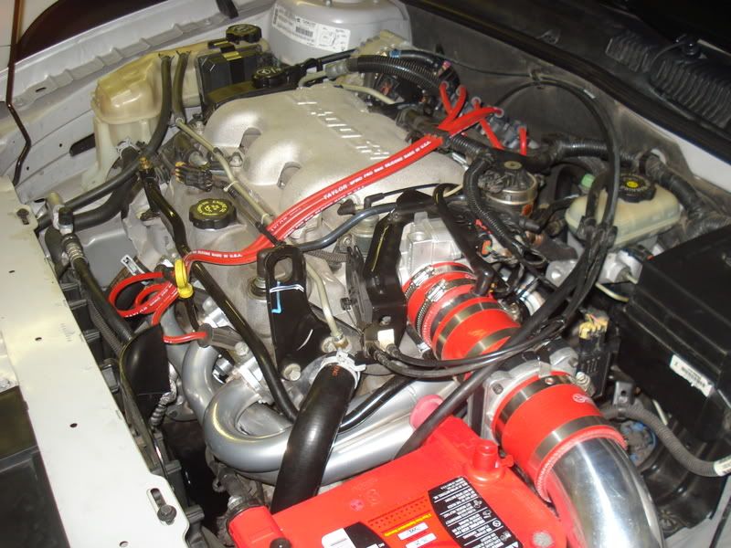

Many '99 and up Grand Am and Alero owners with the 3400 V6 have done warm air or cold air intake mods. IMO the best one to use is a CAI/FWI (fender well intake) which is a true cold air intake since air is drawn in from the high pressure area behind the driver's side headlight and foglight. Supposedly this will give the highest hp increase of these type intake systems. The cone filter is located under the driver's side front fender. This is one we installed from MP Racing. It is a custom unit. A clear plastic shield protects the cone filter from any possible direct water intrusion even though the cone filter is under the fender. There should be no issues for winter use and this particular Alero is now located in New York state.
Also, throttle bodies are heated since coolant is flowing through them which helps out in the winter.
http://i5.photobucket.com/albums/y186/lizzywiz/DSC02684.jpg

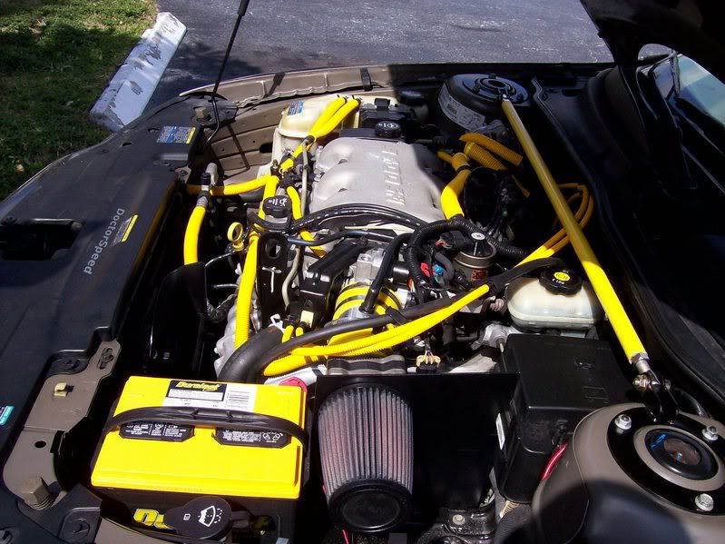

i think im going to get a WAI and modify it. i was planning on buying the one on ebay from chromeintakes. but which one should i get? i seen one that has this chrome heat shield thing. would that be good?
i got one with a shield on it,
http://i25.photobucket.com/albums/c83/Jmoney3318/100_0332.jpg
Ive enjoyed it ever since ive put it on. i like it better than the cold air intake. but hey everyone is entitled to their own opinions

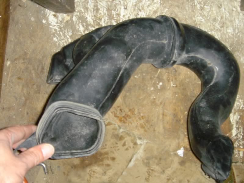

Here is what your stock intake looks like, the part on the right is the "snorkal" that sets behind the headlight, pretty small... I dont think I could breath thru it. Or want to for that matter. lol
http://i28.photobucket.com/albums/c242/xeroinfinity/Cold%20Air%20Intake/DSC00155.jpg

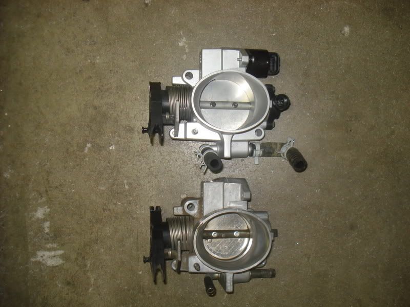

http://i5.photobucket.com/albums/y186/lizzywiz/DSC08242.jpg
Stock and RSM Racing 62mm TB
http://i5.photobucket.com/albums/y186/lizzywiz/DSC07159.jpg
